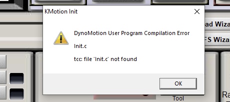

Hello, i have a problem with konnection my Kflop to Mach3. In plugin menu of Mach3 there is no Dynomotion plugin so i cant config it, but if look in Mach3 plugin folder - its installed. Besides at first time after instalation Kmotion over my Mach3 i choose prefer control device as Kmotion Init, but when i try to reload mach3 by presing reset button comes error (photo adding).

I cant understand what i did wrong? I have working Mach3 version, have Kflop board where installed KMotion434. I use stock InitStepDir3Axis config file, what uploaded to Kflop. Mach3 see dynomotion plugin, but when i pressed reset button comes error. What needs to do to figured out?
That indicates it is using the Dynomotion Plugin. The Plugin must be configured to use the Init Program you create.
