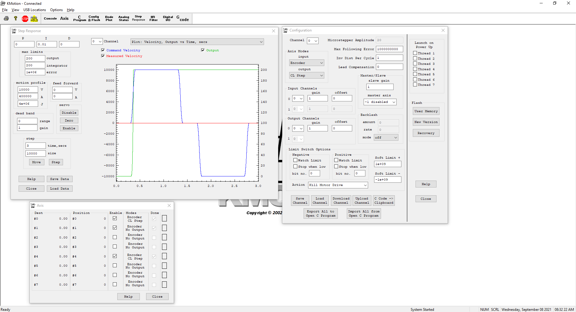

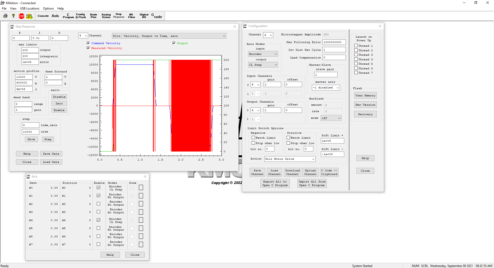

I read the manual and tried so many configurations, my encoder has 1000 lines and i set the micro stepping drive to 4000 pulse/rev. Do i leave it as is in the image. What changes should I make.
- Also,channel 4 has same motor and driver as channel 1 but graph looks much different. Is that because of the amplitude

The encoders are not working. Channel 0 is doing nothing. Channel 4 is just counting +1, -1, +1, -1,... as if the A or B channel wasn't connected or working.
