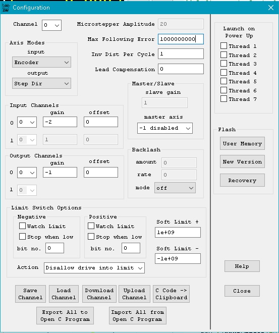

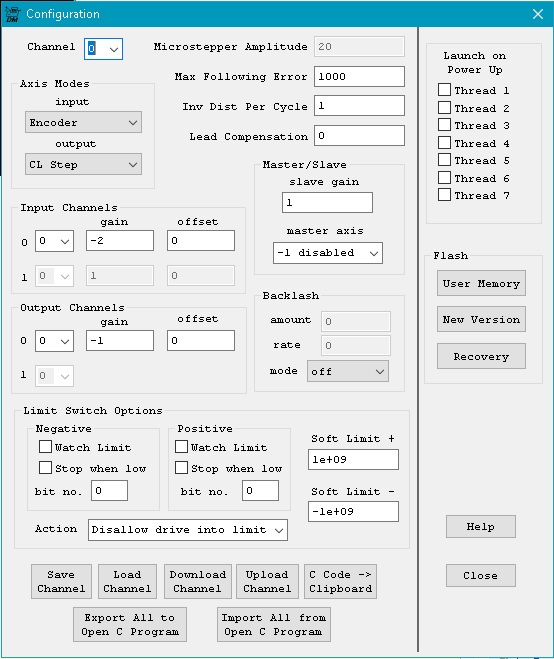

I've attached a screen shot of the X-axis configuration.

Test the closed loop response in KMotion.exe's Step response screen before running KMotionCNC.
Post all your settings for the axis which is the Configuration Screen, Step Response, and Filters Screens and post a Plot of a 100mm motion.
The configuration posted is an open loop configuration.

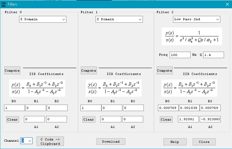

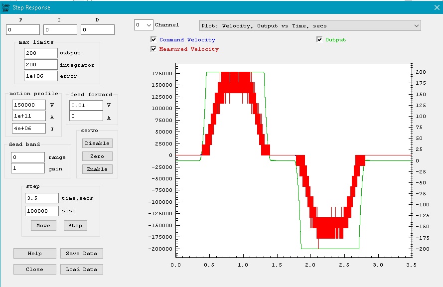

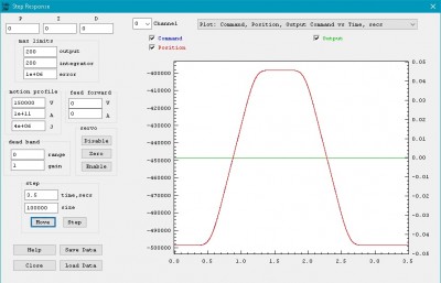

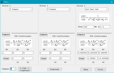

I've attached the information I think you asked for. The maximum distance I can output and still see on the graph's 3.5 second period is 100,000 which actually appears to be 50mm of travel when I check it with a ruler. I don't understand why that doesn't travel 100mm since 1 step is 1micron. I also don't understand why I had to change the Input channel gain to -2 to get it to move 100mm when commanded to move that distance.
I haven't changed anything on the Filters page. On the face of it, the response looks ok to me. It's only the following error that seems to be a problem. The Max Following Error was initally at 500, but it wouldn't run past F2500 without coming to a rapid stop with an error. Opening that figure up to 1000 allows me to reach the max F3000 feedrate.
Since the move is a G1, I would have thought the following error would be very small.

With PID all zero the system is open loop not closed loop. The encoder is not being used. So it should have no effect on the distance moved or the motion. So I don't understand on changing it to -2 would change anything other than you wouldn't get a following error fault if a small Max Following Error limit was set.
Acceleration is set crazy high. So motion is entirely Jerk limited.
Set Feed Forwards to zero. 0.01 x 150000 steps/sec = 1500 steps. This is trying to advance 1500 steps ahead based on velocity. But is limited to 200 steps by Max limit Output. Notice how the Output slams to the limit. I'm surprised this doesn't cause a stall.
Please re-post the plot and data without the Feed Forward and explain what it did.
Again please do not run KMotionCNC until after your Axis is setup, tested, and tuned.
Yes but a position plot would have been more useful. Not much use for a velocity plot. Actually including the data is a good idea so that we can plot/zoom as desired.I've attached the information I think you asked for.
I can't follow your description. Did it move 50mm or 100mm when that plot was made with those parameters?The maximum distance I can output and still see on the graph's 3.5 second period is 100,000 which actually appears to be 50mm of travel when I check it with a ruler. I don't understand why that doesn't travel 100mm since 1 step is 1micron. I also don't understand why I had to change the Input channel gain to -2 to get it to move 100mm when commanded to move that distance.

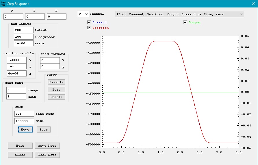

You didn't specify what plot type you wanted, so I just used the default. I'll use one of the distance plots from now on. It looks like the Step data file was too big, so it wasn't included last time. I've compressed it this time.
The motion was 50mm.
Just to make sure we're on the same page, the SureServo is using its own position feedback on its internal rotary encoder to close the motor position loop.
The SureServo has been tuned so that it has its own Feed Forward Gain set to give <10microns following error while it's performing the Step Response here.
The Step & Direction input it's receiving is just the desired position it's trying to control to. This is a closed loop system in itself, and is probably why the accelleration isn't an issue.
I only changed the input gain to 2 because I was originally running the config with Step & Direction, not CL Step. I had to change it then so it moved the right distance. Maybe that's wrong now it's using CL Step?
Anyway, here is the data with the feed forward set to zero. I don't understand why the output is now a straight line. What does the Output represent? The command and position plots lie directly on top of each other.
It moves very smoothly back and forth 50mm, and I'm seeing a very small following error on my SureServo output, so it looks like it's following what it's commanded to do. I'm using the Move button on the Step Response screen. The Step function doesn't move the axis, so I don't know what that's used for or how to move the axis with that.
I'm afraid I dont understand what the plot is showing, and what's limiting the acceleration. The motion profile acceleration figure doesn't seem to affect the Command curve beyond A=1e6 When I set it above that, the steepness of the Command curve doen't increase. I don't think this is stretching the AC Servo acceleration performance to the limit.
Hopefully this makes sense and that's what you intended me to do.
