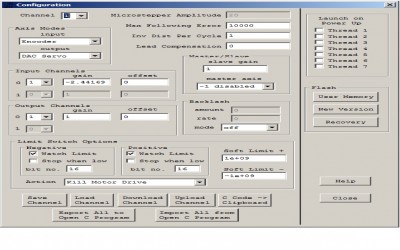

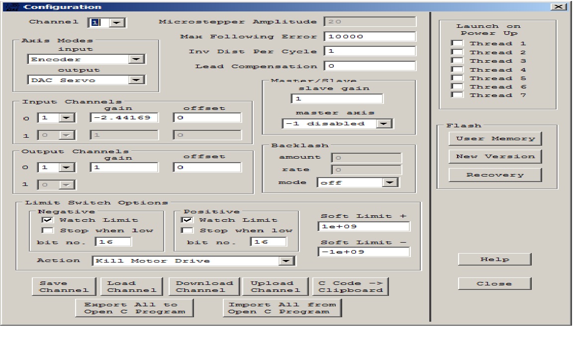

I have attached the configuration for the Y axis.

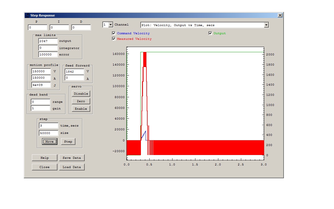

I have attached the step response configured how i think i understand
9 volts = 1842 DAC output.
The axis maximum velocity for 9 volts = 150000 counts / sec = 150.000 mm / sec.
Acceleration = 150000 counts per sec / sec = 150.000 mm /sec /sec.
Jerk needs to be very high so response is trapezoidal.
I would start by commanding a move of 50000 counts / sec = 50.000 mm /sec and then adjust the servo amplifier to match the commanded velocity to the actual velocity.
Where am i going wrong ?

Hi Tim,
I'm not sure what you are trying to do. But with a Velocity FF of 1842 it will output the 9V at a velocity of 1 count/sec. But you are commanding 150,000 counts/sec. So as you see in the plot the output immediately saturates at 10V. The axis moves at its maximum speed of ~150000 counts/sec and then soon gets a following error. You probably want to set the VFF at:
2047/150000 = 0.0136
