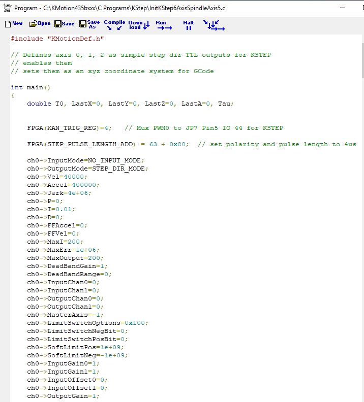

- Posts: 2891
Re: RTCP 5 axis machine
Hi Igor,
That would be normal if you have a KStep.
What boards do you have?
Please post your Initialization C Program.

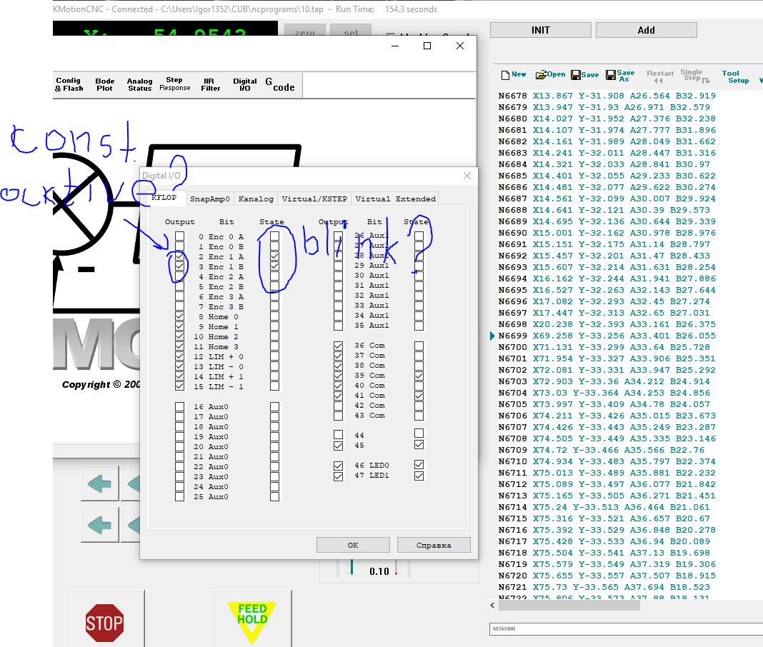

I more often indicated my configuration, only step motors .

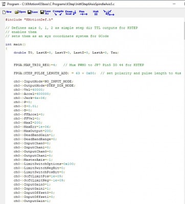

KStepPresent=TRUE; // enable KSTEP input multiplexing---This row has been deleted and the blinking problem persists.
here file of initialization.he is a worker?
Kinematics5AxisTableAGimbalB
PivotToChuckLength = 3.208661 //inches (81.5mm)- Changing values I do not see changes in the simulation test program
- Posts: 2891
Hi Igor,
Start with something very simple such as a line or point with one angle change.
Also your code doesn't turn on RTCP with G43.4 Hxxx
Attach the GCode
The file you posted still has KStepPresent=TRUE;KStepPresent=TRUE; // enable KSTEP input multiplexing---This row has been deleted and the blinking problem persists.
You won't see any difference in the GCode Viewer Plot. It shows the XYZ path of the GCode.Kinematics5AxisTableAGimbalB
Attach the GCode

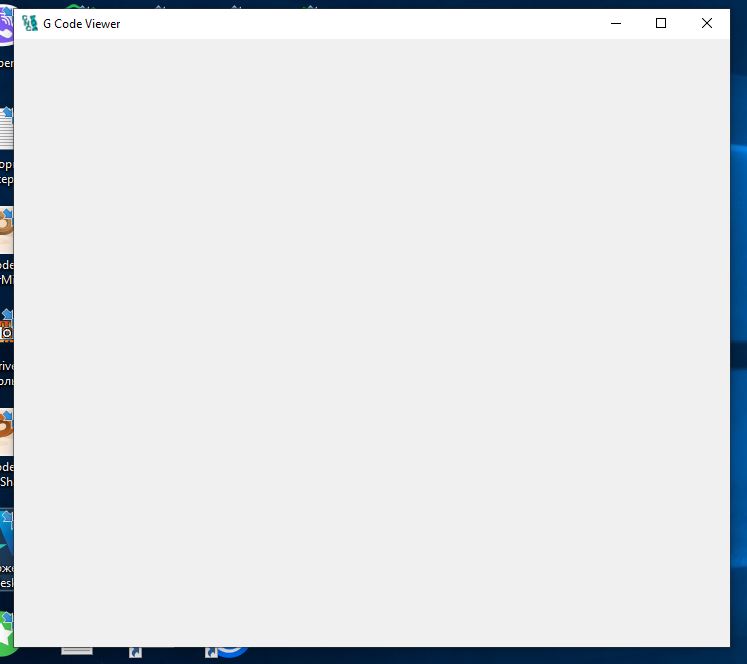

hi Tom. there is a screen. the line is absent. My postprocessor displays code like this. He won 't work?
