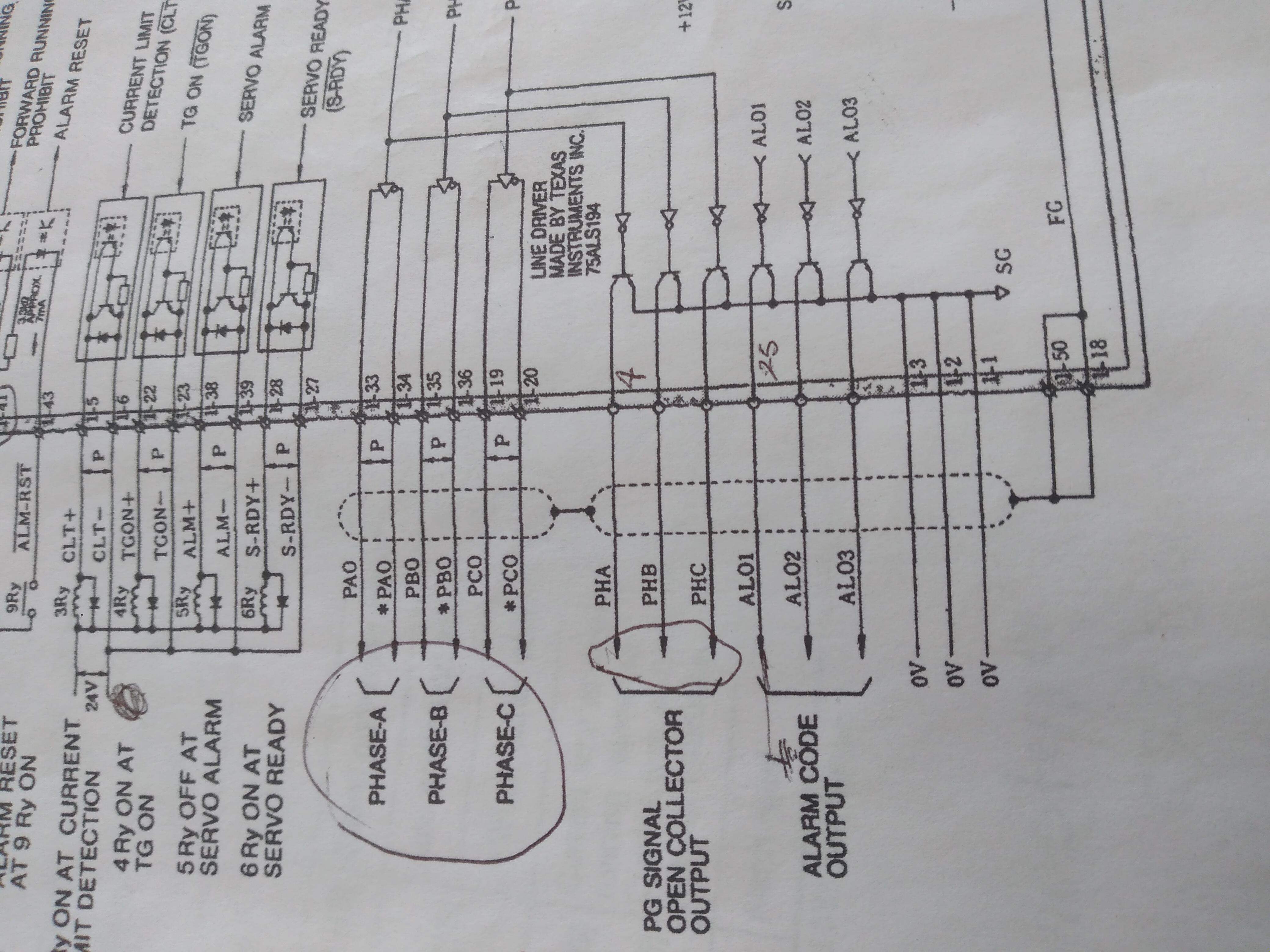

Encoders are connected to the drives originally ,I connected the PHA, PHB outputs from the drive to Kannalog inputs ChA plus 0 to pin 1 and ChB diff plus 0 to pin 3, pins 2 and 4 to GND.

Pins 2 and 4 can not be connected to GND they must be connected to complementary (inverted) ChA and ChB signals.Encoders are connected to the drives originally ,I connected the PHA, PHB outputs from the drive to Kannalog inputs ChA plus 0 to pin 1 and ChB diff plus 0 to pin 3, pins 2 and 4 to GND.
Ok, there are an other outputs available in the drive but not wired from the connector, the schematic diagram shows PAO , *PA0 , PB0, *PB0 , PC0, *PC0 do you think i should use those outputs or its ok with the PHA and PHB, i
- Posts: 2892
Yes use thosethe schematic diagram shows PAO , *PA0 , PB0, *PB0 , PC0, *PC0
