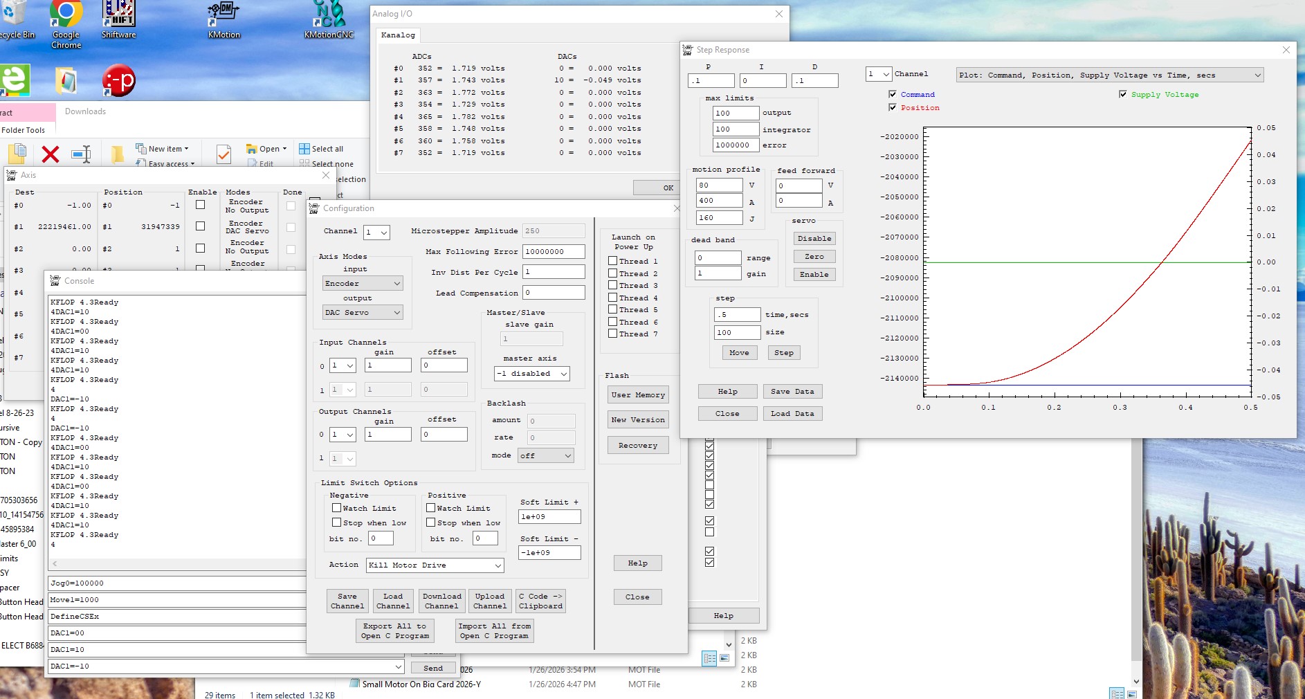

I am working my way through and am a bit confused. I tuned a small frame size (4th axis indexer) glentek DC motor to this drive to get my bearings straight and I had it servoing. Saved the channel and am now trying to get similar results from the larger frame size that drive the other axis. I think all my DC motors are okay too... but. When I power up and Kanalog DACs are 0.000 Volts sometimes the motor creeps. So I put a few lines into the Console.
1 DAC1=00
2 DAC1=10
3 DAC1=-10
The 10 value sets DACS to .049 Volts +/- depending on sign. The negative value will usually stop motion. The positive is a relatively high RPM starts creep but speeds up then stabilizes. My understanding is my drives are acceleration or torque type.
Further weirdness... Whenever I check the Encoder Enable box inside the Axis dialog. The motor takes off, runaway style.
Could be a drive. I might swap them around, but I just had this drive running a small motor without any issue. I ran 2 of the big motors I have with the same runaway/creep results.

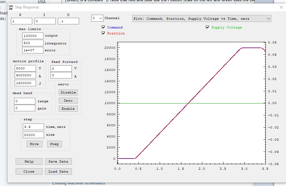

A common cause of runaway when the servo is enabled is positive feedback instead of negative feedback. See FAQ here. If you enable the Axis by pushing "Move" on the Step Response Screen the plot should help understand what is going on.

Also in a Kanalog system there isn't any Supply Voltage information. So on the Step Response Screen Plot Command, Position, and Output to see the DAC Output.

Thanks for the response Tom. We swapped the pos/neg wires on the drive for the main DC and then things began to behave better.
I swapped them back to original position now and changed the gain to neg 1 and that has the same result as swapping motor leads. Thanks for the direction on how to do that.
My next big concern is when I power on the motor spins slowly and then accelerates. Until I enter the -.049 voltage command through the console. Will this need to be tuned out before actually connecting the motor to hardware. It may need to be tuned out of the "pots" on the drive, maybe?
