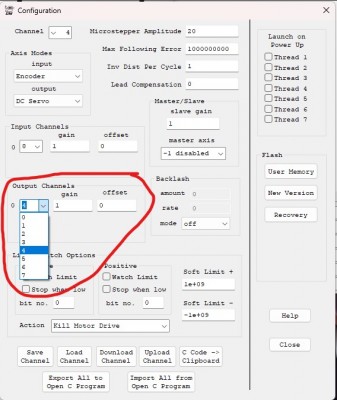

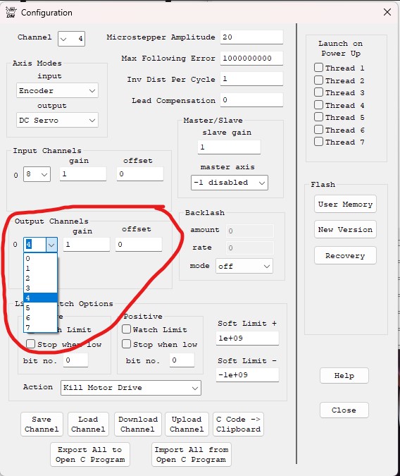

I've recently upgraded my kflop firmware from 2.8 to the latest version and noticed that the Output Channels (via drop-down menu on the config screen) no longer supports anything above 7 when it used to go up to like 32 channels (see attached image).
I had been using channels 8, 9, 10, and 11 for my (X, Y, Z, and Spindle) which are no longer available. Since I'm using the SnapAmp to power the DC servos, which output channels are currently supported?
Can I use Channel 4 in place of Channel 8 and Ch 5 for Ch 9, etc?

FYI, I was able to resolve this by simply typing in the value that I needed and that worked for me.

Thanks for posting back. We will fix this in the next Version.
