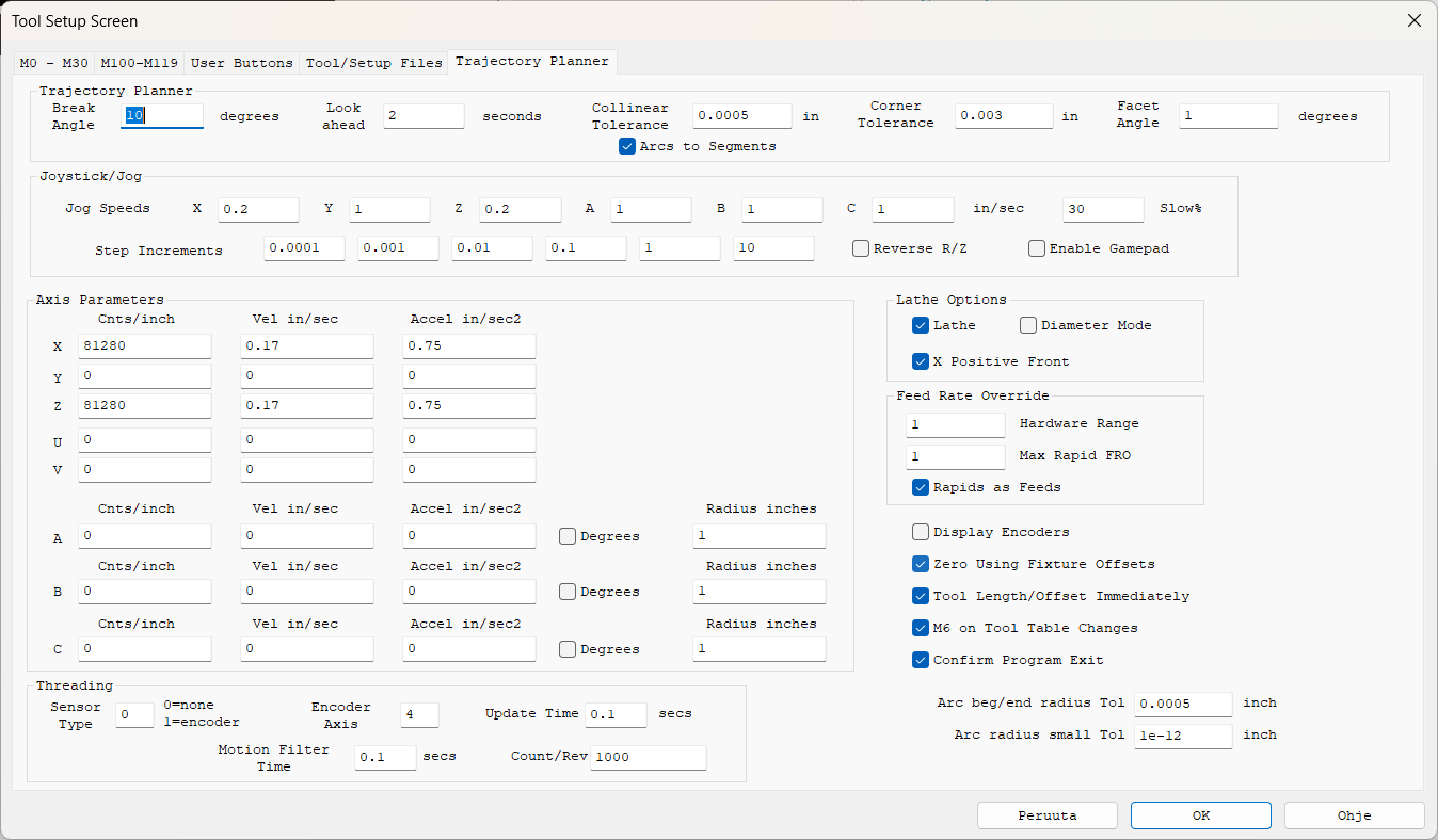

Attached the Init-file (Reset_Sherline.c), the files linked to it (SherlineDef.h and ExtraButtons.c) and a screenshot of Trajectory planner screen.
Now the "Rapids as Feeds" is ticked. It was the only way to slow down the G0 moves: Nothing else was changed. (Today everything worked OK with this "Rapids as Feeds" setting.) So basically for the moment I'm ok. But somewhere something is not quite right...

I can't duplicate the problem with those settings.
If I code
I see a feedrate of 10.3 inches/minute which seems correct. Also if I double the KFLOP Velocity to 28000 steps/sec the feedrate doubles to 20.6 inches/minute.
What are you doing and seeing?
One issue is the Cnts/inch of unused axes are set to 0. Please set to non zero values such as 100 to avoid divides by 0.
