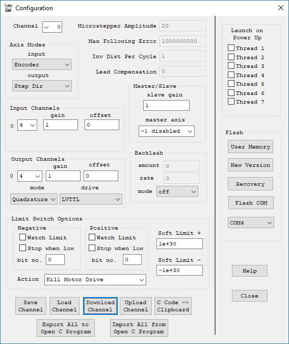

Another ambiguity in the configuration of the axis.
In my machine, the servo amplifiers are controlled by a quadrature signal of 0.25 microns/ step. The measuring linear scale also outputs a quadrature signal of 0.25 microns / step.
The Kflop settings should be as follows:
Input: Encoder
Output: CL Step, output mode: Quadrature, LVTTL.
Input gain= 1
Output gain= 1
However, the axis only works correctly with a different setting: Input gain= 1 ; Output gain= 4. I compared the input and output signals with a two-channel oscilloscope, with this setup, the signals are the same.
Input: Encoder
Input gain= 1
Output gain= 1

Hi Alexanders,
That is strange. What do you mean by "only works"? Does the Destination and Positions change equally on the Axis Screen?
You might post a Step Response Plot with Input gain = Output gain = 1
I commonly simulate an encoder input by outputting quadrature to the same pins as an encoder input and the encoder always changes by the same number of steps. ie JP7 Pins 1 and 2. Step Dir Gen 4 and encoder input #4.

I checked the input and output signals with an oscilloscope again and found out that in fact the Simodrive 611 servo amplifiers perceive each edge of the quadrature signal as a whole pulse. That's why multiplication by 4 is required.
Thank you!
