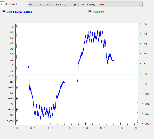

Anyway, here is the data with the feed forward set to zero.
Good. Here is the error plot that the linear scales are seeing with an open loop move (from KFLOP's perspective based on the linear scales). Max errors are ~90 steps (45um) when moving and ~30 steps (15um) when stopped
I don't understand why the output is now a straight line. What does the Output represent?
Because the PID gains and FF gains are all zero no corrections are being made. So the output is always zero. The Output (using the right side scale) indicates how much correction is being made in motor steps.
The next step would be to add PID gains, Low Pass filter, or FF gains to see if you can reduce the errors. Usually a small amount of I gain (ie 0.001) is most useful.
