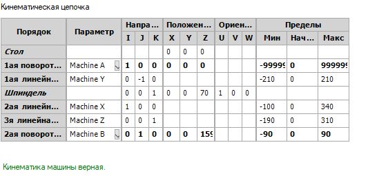

Hello.
Implemented the RTCP function on a 5 axial machine.
It was not the first time.
I had to contact the developer for help.
Thanks to Tom for his help.
The configuration of the machine, as in the picture.
The configuration files Tom sent me.
Result on video.
Kinematics5AxisTableAGimbalB.h
(1.27 KiB) Downloaded 956 times
Kinematics5AxisTableAGimbalB.cpp
(7.43 KiB) Downloaded 949 times
https://youtu.be/PuIdtZKdYfA

Post by TomKerekes » Mon Jan 21, 2019 6:16 pm
Hi Ukr-Sasha,
Very nice work. Thanks for sharing.
I put some of our diagrams on the wiki also.

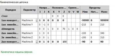

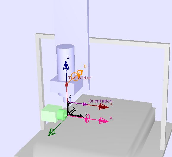

Good afternoon. I need help in machine configuration. I have such kinematics that it is necessary to make changes in the Kinematics5AxisTableAGimbalB .cpp. according to my configuration. I am not strong in programming, I would like to see a guide to application. thanks

Post by TomKerekes » Wed Dec 25, 2019 6:44 pm
Hi Igor,
Did you read the wiki?
I would expect CKinematics5AxisTableAGimbalB should work for you by only changing PivotToChuckLength.
What is your PivotToChuckLength?
Are you able to re-build the libraries as described here?

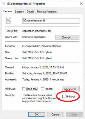

I made a patch for Version 4.35b to allow you to set the PivotToChuckLength as a parameter for Kinematics5AxisTableAGimbalB in the text file:
C:\KMotion435b\KMotion\Data\Kinematics.txt
So now the kinematics type can be selected and the parameter changed without needing to re-build the Library with Visual Studio. Hopefully those kinematics work for you with only changing that value.
Here is the Kinematics.txt file to set the PivotToChuckLength to 81.5mm
PivotToChuckLength = 3.208661 //inches (81.5mm)
To apply the patch, copy this GCodeInterpreter.dll to the C:\KMotion435b\KMotion\Release folder.
To activate RTCP use GCode G43.4H1

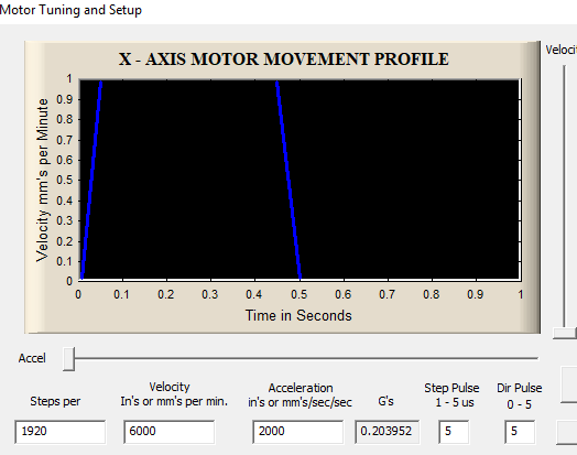

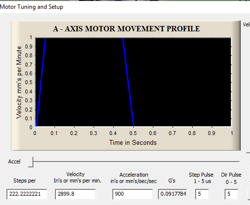

good afternoon. Problem copying (copy this GCodeInterpreter.dll to the C:\KMotion435b\KMotion\Release folder) with replacing program file "closes." it is possible to hear your recommendations on settings of Leadshine NEMA34 motors of 1143 ounces 8Nm the closed contour the step engine a set 863HSM100H-E1 H2-2206S 3 phase - these motors operate axes of X,Y, Z/axis A - the step motor, through a reducer 1/50. Axis B stepper motor, via 1/100 reducer. Settings are taken from mach3. Also do not understand where it is necessary to add GCode G43.4H1, make changes to the postprocesor. A managed program is created in Delcam PowerMill 2016. Thank you for answering so quickly
I don't understand what you mean by this. Sometimes when downloading executables from the Internet Windows blocks them from executing unless you "unblock" them. Try right clicking the file, then select properties, then check unblock to see if it helps.
I couldn't find a proper manual/specification for those drives.

yes I know mach3 does not support rtsp. settings cited as an example. here is the official site please see there. http://leadshine.com/productdetail.aspx ... =ES-DH2306

yes I know mach3 does not support rtsp. settings cited as an example. here is the official site please see there. http://leadshine.com/productdetail.aspx ... =ES-DH2306. Unblocking doesn 't work, KMotion doesn 't work.
