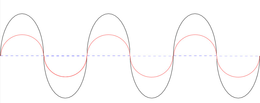

I need for an application to be able to create this motion in XY plane, see joined picture.
For that I would like to use the existing G2/G3 GCode instructions: this would output the red trajectory.
BUT the customer requirement is the black trajectory => an arc with a modified Y scale factor.

Hi Frederic,
I'm not aware of a simple way to do this.
You could change the Y axis scale but that would change it for everything.
You could create such a path with many short line segments. You might look at the Polygon.ngc example which can create a many sided ploygon to approximate a circle. You could modify it to do a half circle and use a different radius for X and Y.
