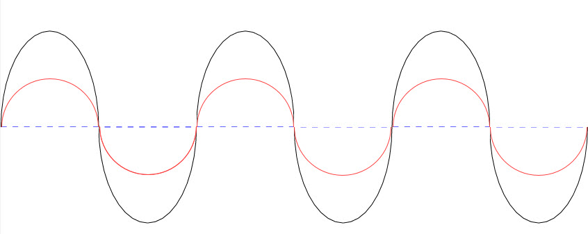

I need for an application to be able to create this motion in XY plane, see joined picture.
For that I would like to use the existing G2/G3 GCode instructions: this would output the red trajectory.
BUT the customer requirement is the black trajectory => an arc with a modified Y scale factor.
I know that a G51 scaling feature exists on some other CNC controllers.
the code would be like this
G0X0Y0
G51 Y100 (scalefactor for Y changed to 100 counts per unit, X not changed)
G2 X4 Y8 I2 J3 (arc motion)
G50 (cancel scaling)
G0 X0Y20 (move to this position with the "original" scalefactor)
The requirements are that only the arcs should have a modified scalefactor.
other moves should be done with the original scalefactor during execution
Is this possible with Kogna?
Maybe I'm wrong and there is an existing GCode programming possibility to do this "modified scale" arcs motions.
Frederic from DOMinfo (France)

Hi Frederic,
I'm not aware of a simple way to do this.
You could change the Y axis scale but that would change it for everything.
You could create such a path with many short line segments. You might look at the Polygon.ngc example which can create a many sided ploygon to approximate a circle. You could modify it to do a half circle and use a different radius for X and Y.

Hi Tom
Thanks for your input. I will take at a look at this polygon.ngc example.
It's actually a showstopper to retrofit an existing machine from Baldor Nextmove (which handle dedicated Mint programs in memory) to your new Kogna board reading a GCode program.
I already used your KFlop on 4 axis milling machine some years successfully so I'm confident on your hardware.
I hope to find a good software solution for using Kogna to solve this topic.
Frederic
Frederic
