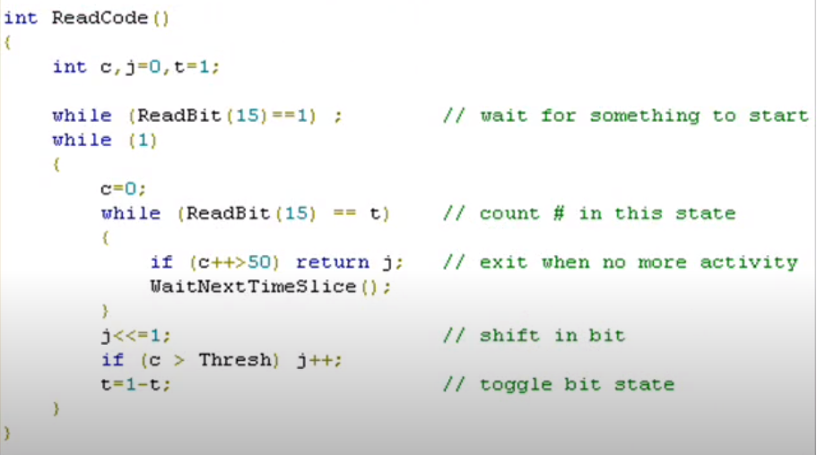

Hi Katie,
What kind of IR Control do you have? What is the timing?
See this demo video:
This IR Control output a sequence of state changes with "long" or "short" times between change to indicate a 1 or 0. If the time was less than 0.001 seconds a 0 was indicated. If longer a 1 was indicated.
Your code appears to just sample every 0.2 seconds (plus whatever time the printout takes) so the data transmission is probably way over by the time of the first 0.2 second delay.
I can't locate the code used in the demo from years ago but here is a screen shot from the video showing how the code is determined.
The KFLOP Time slices are 90us. With just one User Thread running running the next time slice will occur 180us later. So if the transition occurs after 6 Time Slice it is considered to be a long time.

int currentAxis = -1; // Global variable to track the current enabled axis
// Function to process command
void ProcessCommand(unsigned int IRCommand) {
switch (IRCommand) {
case BUTTON_1:
if (currentAxis != -1) DisableAxis(currentAxis); // Disable the current axis if one is enabled
EnableAxis(2); // Enable Axis 2 for this example
currentAxis = 2; // Set the current axis to 2
printf("Button 1 pressed. Axis 2 enabled.\n");
break;
case BUTTON_UP:
if (currentAxis != -1) MoveRel(currentAxis, 9600);
printf("Button up pressed. moved positive 9600.\n");
break;
case BUTTON_DOWN:
if (currentAxis != -1) Move(currentAxis, -9600);
printf("Button down pressed. moved negative 9600.\n");
break;
default:
// Handle unknown command
break;
// Function to receive a character from RS232
unsigned char ReceiveChar() {
// wait for data in buffer
while ((FPGA(RS232_STATUS) & RS232_DATA_READY) == 0);
return FPGA(RS232_DATA);
// Function to receive a full command (until newline)
unsigned int ReceiveCommand() {
unsigned int command = 0;
unsigned char ch;
do {
ch = ReceiveChar();
if (ch >= '0' && ch <= '9') {
command = (command << 4) | (ch - '0');
} else if (ch >= 'A' && ch <= 'F') {
command = (command << 4) | (ch - 'A' + 10);
} else if (ch >= 'a' && ch <= 'f') {
command = (command << 4) | (ch - 'a' + 10);
// Repeat until newline or carriage return
} while (ch != '\n' && ch != '\r');
return command;
void main() {
SetBitDirection(45,1);
FPGA(RS232_BAUD_REG) = RS232_BAUD_9600;
// FPGA(KAN_TRIG_REG) = 1; // enable Kanalog to get RS232 working
for (;;) {
//printf("Waiting for command...\n"); // Debugging line
unsigned int IRCommand = ReceiveCommand(); // Receive a full command
ProcessCommand(IRCommand); // Process the received IR command
This set of codes runs perfectly, enabling the axis and moving the stepper motor. Yet, it necessitates an additional Arduino board for operation. I'm wondering if this could possibly be achieved by the Kogna board independently , potentially through either the UART pins or the JP7 pins.
Thank you.

- Posts: 2954
Re: IR remote control-Kogna
You aren’t showing the Arduino code that decodes the IR sensor. You would need to understand the IRrecv class to understand what it is doing.
Please post any code using the <\> code tags to make your posts more readable.
