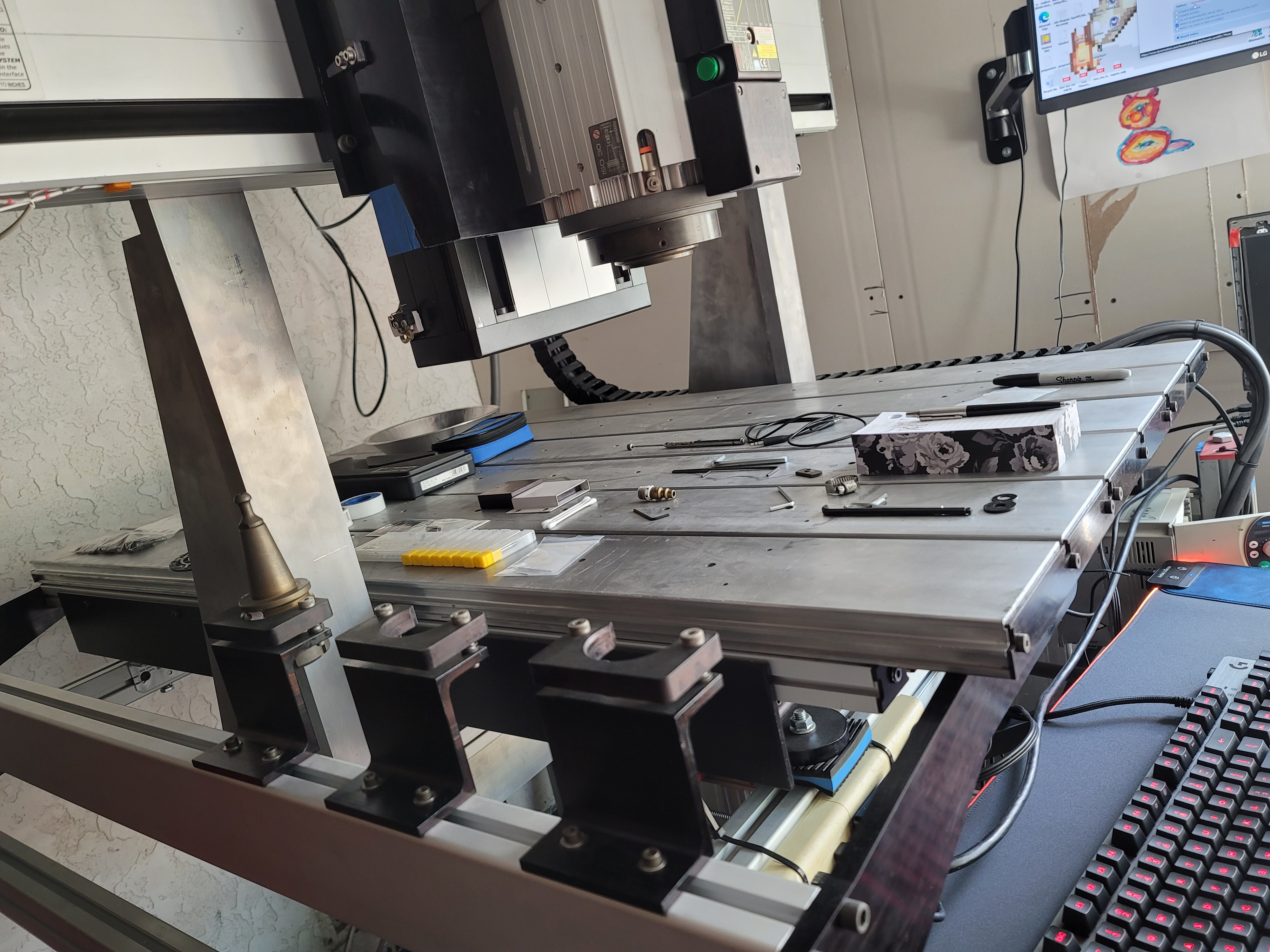

So I have 3 parking spots that are an almost perfect transplant for the provided linear tool change code.
I did my best to change the code to suit but I have 2 wrinkles.
1 : my machine homes to the back right to 0,0 but everything on the table is negative in terms of absolute coordinates.
2 : my tool parking is linear along the Y axis instead of X which I think is what the code was originally written for.

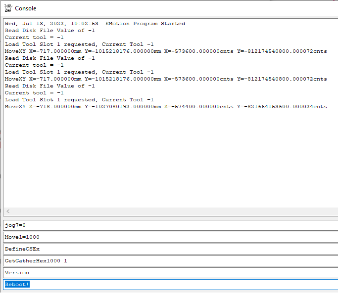

if (MoveXY(ToolPositionY(Tool),HOLDER_X,SlowSpeed)) return 1;

if (MoveXY(HOLDER_X+AXIS_SAFE_DISTANCE_X,ToolPositionY(Tool),SlowSpeed)) return 1;

if (MoveXY(TOOL_CHANGE_SAFE_POS_Y,TOOL_CHANGE_SAFE_POS_X,SlowSpeed)) return 1;

if (MoveXY(ToolPositionY(CurrentTool),TOOL_CHANGE_SAFE_POS_X,SlowSpeed)) return 1;
// - After matching Y position, match tool X position
if (MoveXY(ToolPositionY(CurrentTool),HOLDER_X,SlowSpeed)) return 1;

float ToolPositionY(int tool)
return (HOLDER_Y_2-HOLDER_Y_1)*(tool-1) + HOLDER_Y_1;

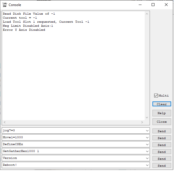

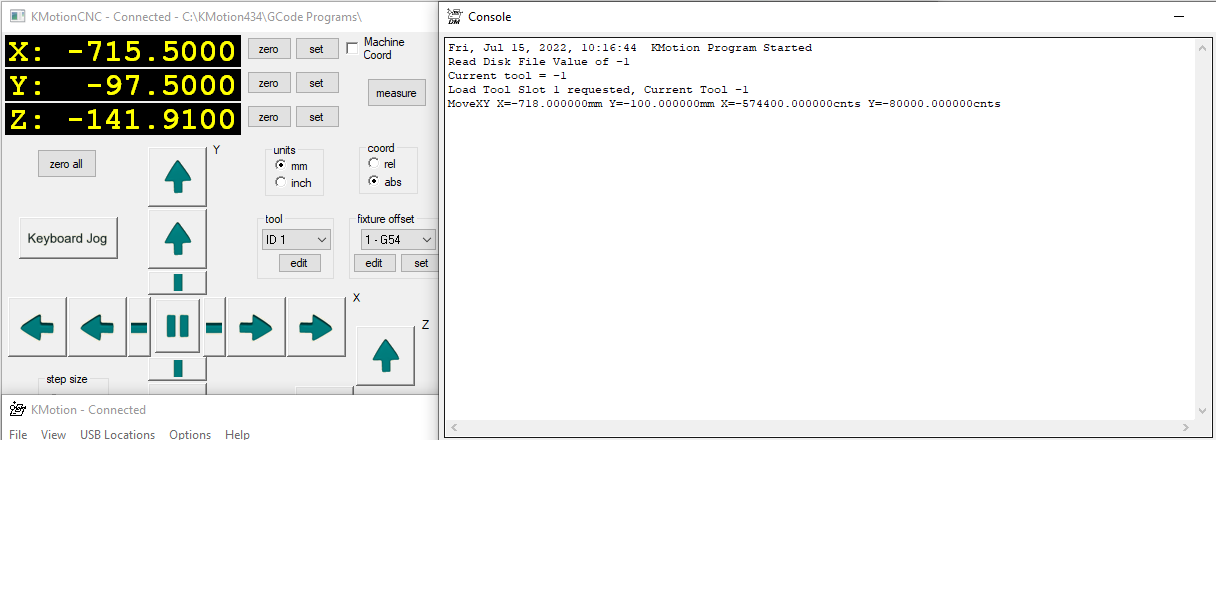

My issue is that when I try to call tool one (id1001) per the interface, the machine moves simultaneously on x and y in the correct direction but it runs into the limit switch instead of stopping when it hits Y-253mm like I think it should. The max for Y is more than my measured coordinates for the parking spot so I dunno why it overshoots. My DRO in Kmotioncnc reads more than the value of the expected stopping point as it forks off into the reeds.
- Posts: 2933
Re: C noob having a rough time tweaking the linear tool changer code
I think in a few places calling MoveXY have the X Y values swapped. Should be X then Y.
You might also tell us what is printed to the Console.
Please post Code within the Code Tags so it is more readable.
So I think I fixed everywhere that I reversed the x and y. Unfortunately I get the same result. If I home the machine and then zero all axis, I then click id 1 under the tool dropdown I get a box that prompts if there is a tool in the spindle. I enter -1 for no and hit ok and the box goes away as the machine moves on x and y. When it hits a limit switch I get an error that pops up saying that the axis is disabled. If I stop the machine mid tool change I get a claw still loose error. Maybe I am calling the tool change incorrectly? Or I need to change something to make the machine stop as it reaches it's destination because it is moving in a negative direction towards a negative destination?

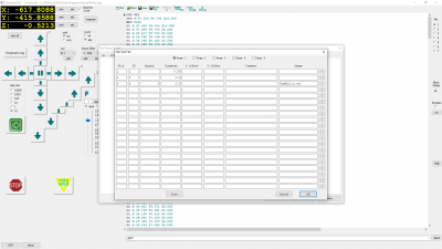

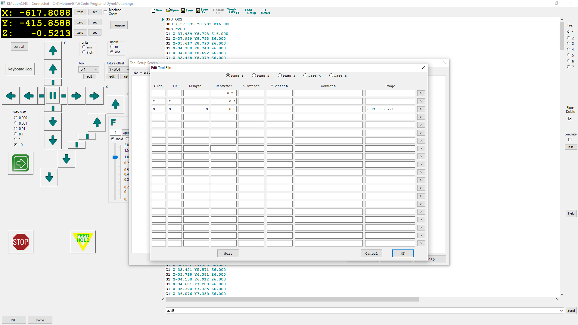

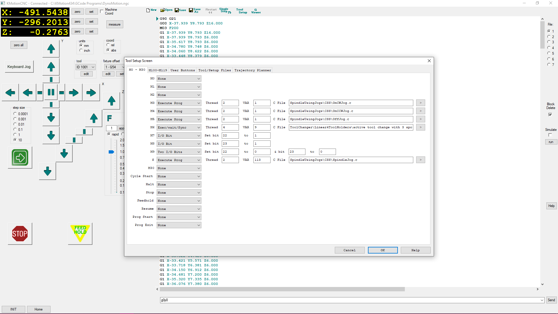

Here's the tool setup screen and my tool file
Thanks for any advice. I'm pretty stuck on what else to try.

- Posts: 2933
The code looks reasonable to me.
is 800 counts/mm correct for your machine?
You didn't tell us what is printed on the KMotion.exe Console Screen.
Its very simple to debug these types of issues by adding printf statements.
Add this printf to the beginning of your MoveXY function:
Then make a tool change to slot 1 again and tell us what is printed on the Console Screen.
printf("MoveXY X=%fmm Y=%fmm X=%fcnts Y=%fcnts\n",x,y,x * CNT_PER_MM_X,y * CNT_PER_MM_Y);Regards,
800 counts per mm is correct afaik. The machine says 20320 for scale factor and I did the math, converting to mm=800. Also, I didn't know what print to console meant but I've got it now. Initially I got the same error as this post =>
https://www.cnczone.com/forums/dynomoti ... -code.html
So per that thread I made a temp folder and named a text file toolchangerdata with -1 as the only text. Having tried another another tool change after adding that print command I get this... as the machine hits the Y limit switch.
- Posts: 2933
Desired new tool is 1 and Current as -1 looks correct
I don't see a Move XY printout. Did you add it? Please re-post the file with it added.

Now that It's telling me where it's going I can see that it is trying to send Y to outer space.
I read back through to try and find why it would ignore my Y holder location, that I put at the top, and I found a formula a ways down:
//return y position of tool holder as a function of the tool
I get a slightly different value from the print command on Y when I call tool1 but it is still comically incorrect. the first 2 coordinates are my original code just with the print command inside the brackets for move xy and the last is after I changed my holder Y locations and inverted the sign in the formula.
- Posts: 2933
I see we forgot to define a function prototype for:
float ToolPositionY(int tool);
When the Compiler first encounters that function it basically makes a guess on what type of return value and parameters it has. Later when the function is actually defined if it is different then the result is basically garbage. 'float' and 'int' memory formats are different. We should always declare function prototypes near the beginning of the file (before any function calls) to avoid this issue. The TI Compiler can be invoked by right-clicking the C Program editor. It is more thorough at warning of this.
Regarding the formula: the idea is if there are a bunch of tool holders all equally spaced, then the nth position can be determined by that formula which is simpler than a bunch of checks for what tool and then fetching the corresponding positions.
btw the code you posted doesn't compile. There is an extra printf statement left in before the MoveXY function.
Ok getting pretty close now, first issue is that now that I have the commanded position correct I can see an offset of some kind at the holder when I get there.
the spindle starts moving down with a 2.5mm difference from what the tool changer code is sending. I checked the tool setup and I have a .25 diameter for tool one. Assuming that page is in inches, .25" diameter doesn't equal 2.5mm radius so I think I have an offset somewhere else I am not aware of.
The next issue is that the code needs more tweaking for my personal machine because my holders are C shaped instead of U shaped so I can't just leave straight out the side. I have to lift up a little before making my X move. I tried adding a move X and Move Y command to help facilitate these moves but my program won't compile. I am obviously not understanding something about how the code works because just slapping new commands in doesn't jive
I assume it has something to do with moveX not being defined in the KMotionDef.h or KflopToKMotionCNCFunctions.c
Can I add easily add it? Or is there a sneaky workaround to move on a single axis at a time? MoveZ works fine so I know it can be done.
Here's the freshly mangled code
Thanks a bunch! Again. Lol

- Posts: 2933
Regarding offset: Do you have exactly the same counts/inch in the KMotionCNC | Tool Setup | Trajectory Planner | Axis Parameters | Cnts/inch?
800 counts per mm would be 20320 counts per inch.
You might switch KMotionCNC DROs to machine coordinates to avoid any offset issues.
I see the DROs are shown in yellow. This normally indicates the axis are disabled. Are they? What is shown on the KMotion.exe Axis Screen?
Yes you must create a function to move only X if you need to do so. Copy the MoveZ functions and change all Z's to X's.
