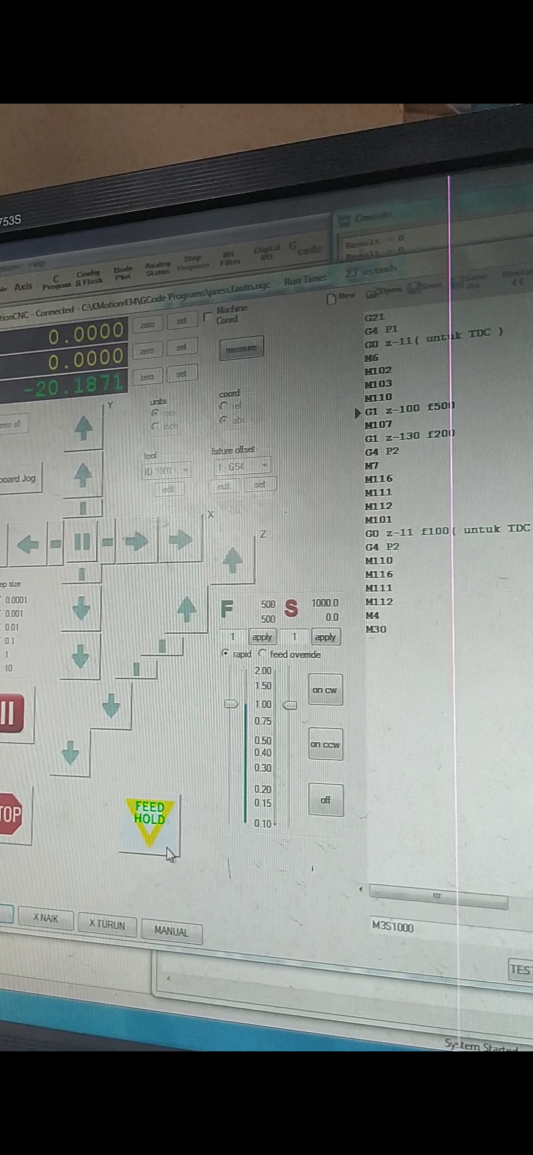

irmad
Posts: 47
Joined: Sun Jun 07, 2020 1:39 pm
Re: make the machine semi-auto.
Post by irmad » Thu Jul 15, 2021 5:02 am
how to make the jog panel in kmotion CNC work?
please help to provide an example script?
Posts: 2934
Post by TomKerekes » Sat Jul 17, 2021 12:56 am
The Z Jog button should work. But you will probably need to set your relays properly for how you are Jogging.
irmad
Posts: 47
Post by irmad » Tue Jul 27, 2021 3:25 am
the relay settings are correct, sir.
so,
how to display encoder position for x and y in KmotionCNC panel? and how to edit it or add it in the Kmotion CNC panel?
because, currently only the Z coordinates are displayed.
Posts: 2934
Post by TomKerekes » Tue Jul 27, 2021 3:20 pm
Hi irmad,
The photo you posted has the XY axes on the screen. But they are yellow. I don't see any configuration for any XY axes in your Initialization C Program. You will need to Configure the XY Axes, enable the axes, and add them to the Coordinate Motion System with the DefineCoordSystem() function.
