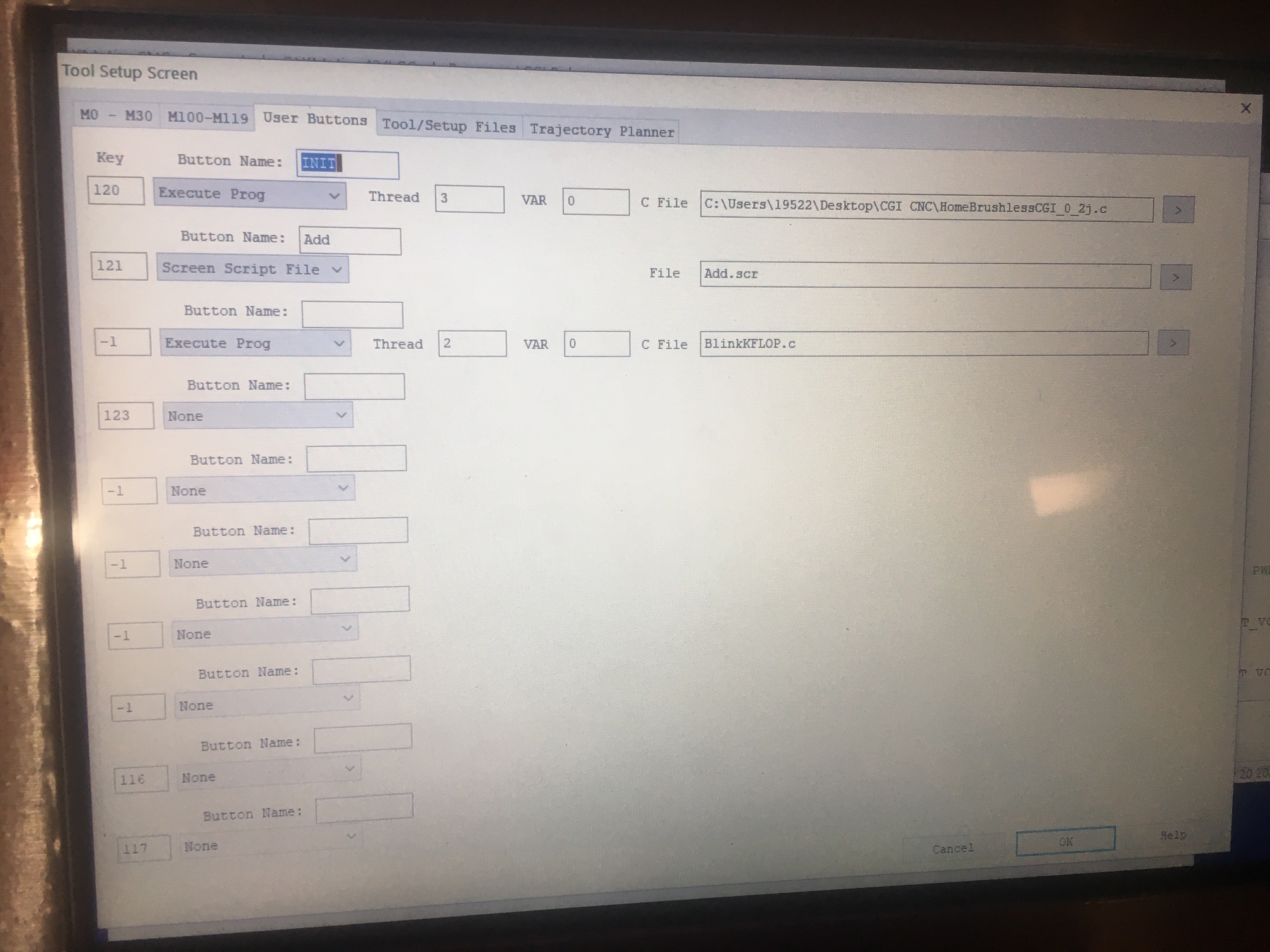

Do you have any other Action configured to run in that Thread? Running a C Program in a Thread will kill any program currently running in that Thread.

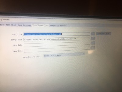

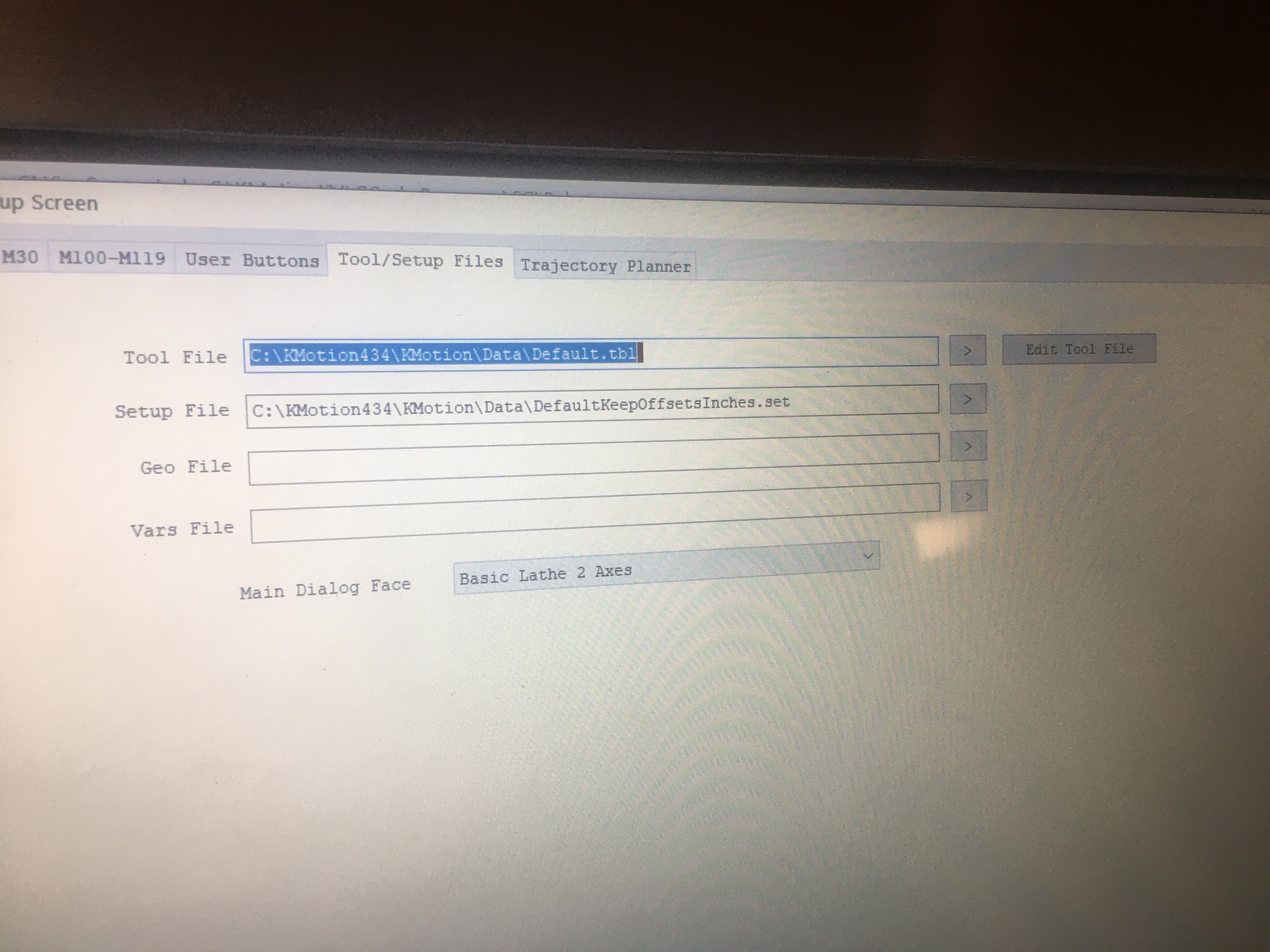

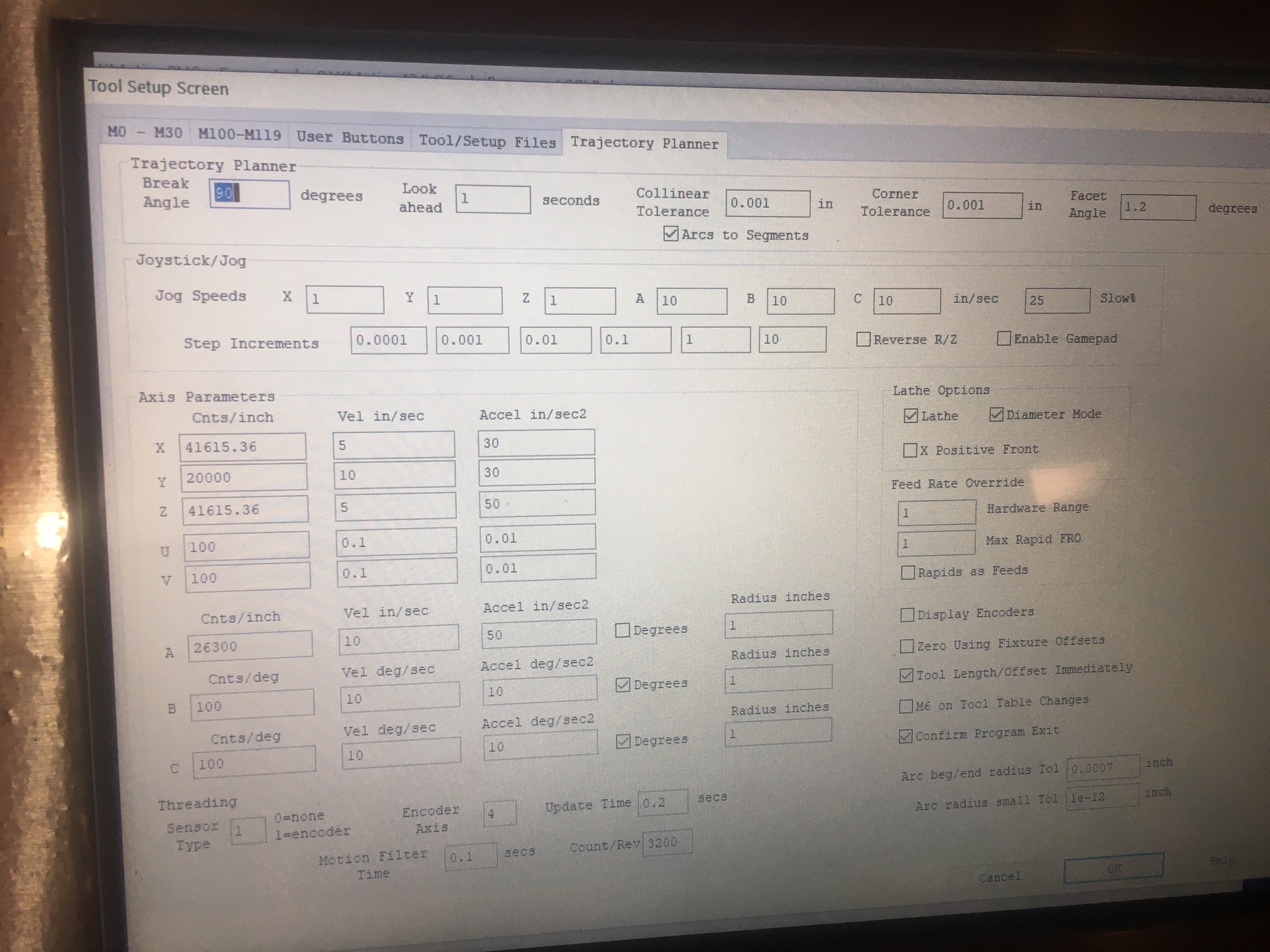

Please post your Tool Setup Screens.

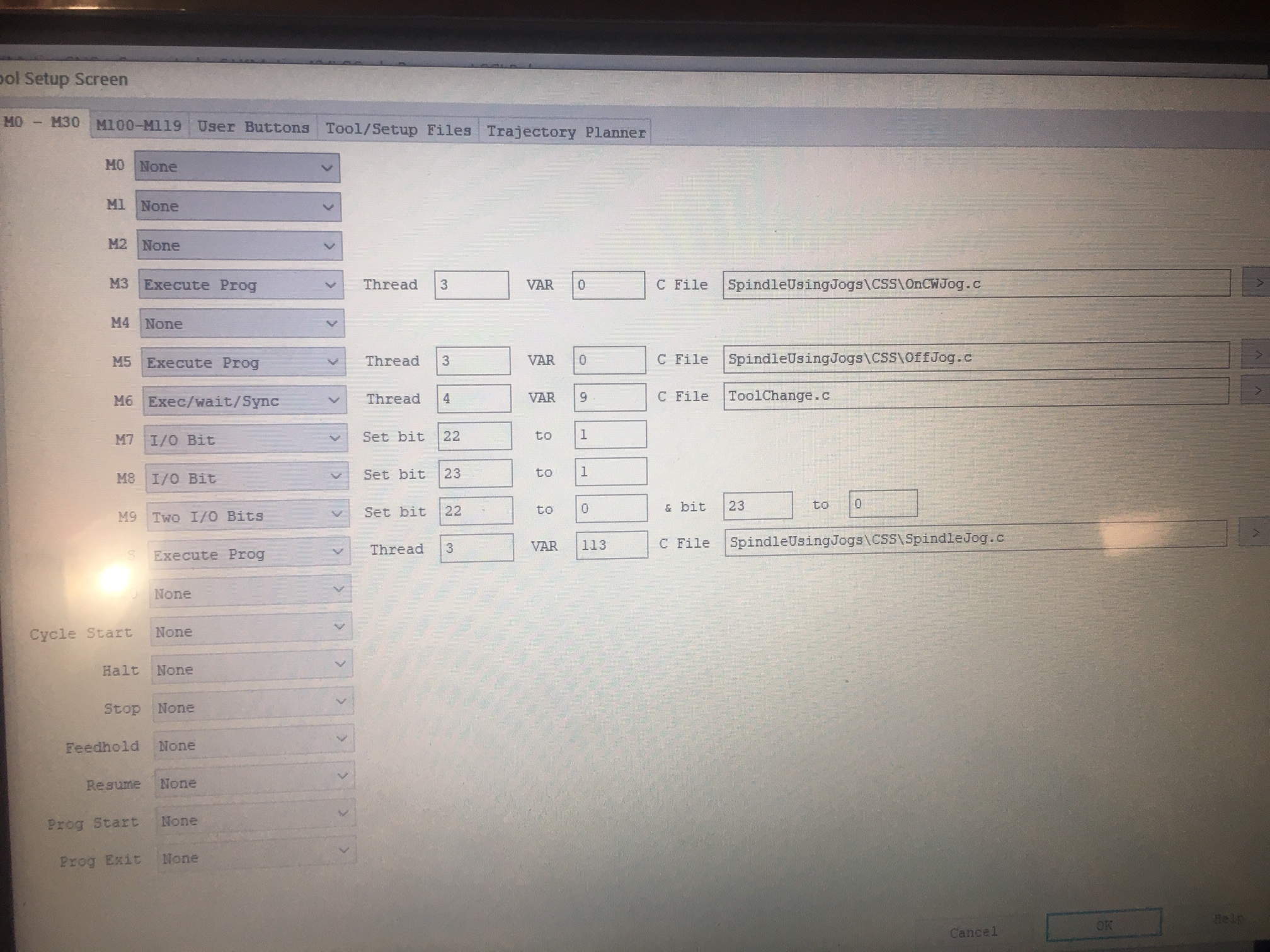

See attached photos. The C program is running in thread #3. I see where there are other C programs called by Mcodes and user buttons calling that same thread (#3) but I'm not activating those. I'm just running the G code program until it stops. Is there still some interference there?

M2 causes the Program Stop and automatically turns off the Spindle by calling the M5 Action which you have set to use Thread #3.
