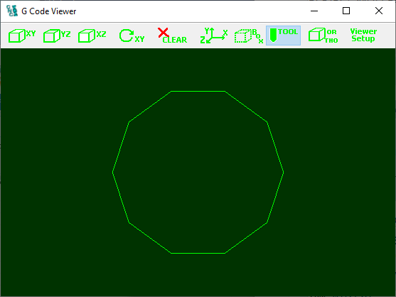

also i would like to learn if there is a repeating macro or command i can get to run the same cutting path then stop and index to a new position. then repeat this 32 times.
See the Polygon.ngc example that creates an N sided polynomial using a subroutine (O100) called N times:
(simple polygon)
#1=0 (start angle)
#2=10 (number of sides)
#3=1 (radius)
G20 G90
G0 X#3 Y0
F40
m100
M98 P100 L[#2+1]
M2
O100
G1 X[cos[#1] * #3] Y[sin[#1] * #3]
#1 = [#1 + 360.0 / #2]
M99
