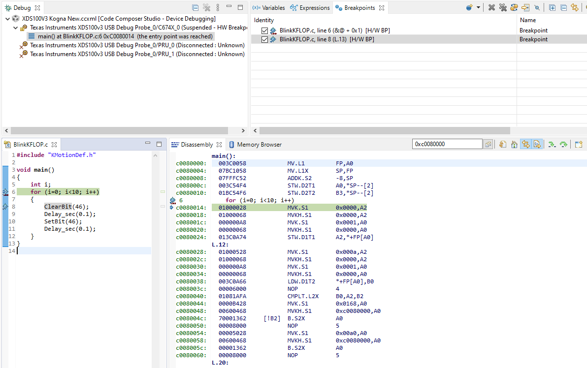

Q: how does one coax CCS into allowing breakpoints to be set by C program/line number? At present I can step through, and it highlights the C source line correctly, but breakpoints can only be set on known symbols, which forces me to create dumb little functions all over the place. If I try to set on a C source line, it complains that it doesn't know the source file (!)
More info: I inserted lots of calls to Delay_sec(0.4) in the homing thread (2), to give the supervisor (7) plenty of time to run though several cycles of its housekeeping. First axis to home (Z, axis 2) goes fine. Second axis (X, 0) runs up until it makes a call to Zero(i) where i is a local int containing the axis number, 0. I can single step over that call, but then the next time it calls Delay_sec(0.4), it never returns. This is the most consistent I've seen it. Previously, I was using Delay_sec(0.04) but that would make it fail at a later point. In theory, the supe housekeeping cycle takes 0.036, but maybe with all the debugging stuff enabled it's taking longer than expected.
Anyway, to get more detail I was stepping in assembler thru the Delay_sec() routine etc., and it actually returned, but while stepping through some more it entered then was returning from another Delay_sec() call and suddenly CCS locked up on me (but after going to a weird place after 0xC008000 i.e. first thread, which is also waiting for things to finish at that point - maybe an interrupt is happening and it switches context back to that thread). I wasn't mentally acute enough to keep track of all 64 regs in my head so missed where B3 was getting set incorrectly. Until now, I'd never encountered a context switch while stepping in asm. But it seems CCS get all bent out of shape if that happens.
Next thing to suspect is the compiler. Currently I'm using -g but also with -O2 --opt_for_space so it might be wise to turn all that stuff off. It's throwing off my debugging a bit.
- Posts: 2923
Re: Kogna debug suggestions
Good point I hadn't thought through. But I'm not sure if that is necessarily true. That's the quirk with this processor. Because instructions are pipelined 5 cycles if an interrupt occurs during the 5 cycles the interrupt will still happen, the pipeline will be flushed (turning off the interrupt), and then the interrupt routine will be entered with interrupts turned off. I know this can happen with global interrupts but not sure about the IER. Unlikely to be an issue if some random code is just turning off IER[6]. But with code frequently switching interrupts off momentarily it is quite likely, like certain library functions.The only problem I can see is if IER[6] was turned off, then it would never get inside the user callback since that's the 90us periodic timeout.
I can't think of how a break that wasn't set would occur. I think software breakpoints are some special instruction code so if that were somehow executed it might break.Interrupts get disabled and it finds some random piece of looping code to get stuck in. (The JTAG debugger seems to have a means of detecting this, and it seems to automatically break into the debugger and disasm where it's at. Maybe some sort of timeout?)
I don't have a problem with this. If I "Add Symbols" for my User Program. Then Open the User C Program as a file. Then right click on a line of C Code and select Breakpoint - hardware breakpoint. Breakpoint is set and if the C Program is loaded and executed it breaks. If the code is Optimized then the code might be removed, reordered, and whatnot to make setting breakpoints difficult.Q: how does one coax CCS into allowing breakpoints to be set by C program/line number? At present I can step through, and it highlights the C source line correctly, but breakpoints can only be set on known symbols, which forces me to create dumb little functions all over the place. If I try to set on a C source line, it complains that it doesn't know the source file (!)
I don't think interrupts are normally allowed when single stepping. You might set a breakpoint in your CallBack to check. Below is the C code and assembly for Delay_sec. I've also attached the C File timerCounter.c which contains Time_sec if that helps.Anyway, to get more detail I was stepping in assembler thru the Delay_sec() routine etc., and it actually returned, but while stepping through some more it entered then was returning from another Delay_sec() call and suddenly CCS locked up on me (but after going to a weird place after 0xC008000 i.e. first thread, which is also waiting for things to finish at that point - maybe an interrupt is happening and it switches context back to that thread). I wasn't mentally acute enough to keep track of all 64 regs in my head so missed where B3 was getting set incorrectly. Until now, I'd never encountered a context switch while stepping in asm. But it seems CCS get all bent out of shape if that happens.
Note there is an array called SaveIRP which contains where each Thread was last pre-empted if that helps.
No, but I don't think the compiler should be optimizing that out since it doesn't really know what Delay_sec() might do. I probably should declare the "supe" pointer as pointer to volatile, which would remove any question in this and other cases, but at present doing so causes a whole bunch of compiler warnings. I would think that any such errors on my part would cause the thread to loop endlessly, but should not end up with disabled interrupts.Is thd_function defined to be volatile?
I just tried replacing the Delay_sec(0.5) with a WNTS and it failed in the same way.
After 3 weeks of looking at this, I'm fairly sure it's not my code doing anything wrong, especially since exactly the same code has been running for years on the kflop. I've meticulously searched for the usual suspects like uninitialized data, bad function pointers etc. and never found anything suspect. What I have found is that when 3 threads are all in a Delay_sec() or WNTS, then things go all pear shaped - but not immediately. I'd break it down into a simple example, but since we've moved towards a more specialized platform, it's not that easy.
Probably, where I'll go from here is to find all such cases where unnecessary stub threads are waiting, and change to something more efficient. It does the same thing with touch probing, and some other M codes, so that'll be fun

Hi Steve,
On another occasion I recall trying to write a benchmark to sum an array of numbers. I'd fill the array with a count, then sum the array, then print the result. When I turned on optimization it would just print the result! Even though the summing was moved to a separate function.
I don't know if any of this is related to your problem but wanted to mention it. It isn't clear if you are testing with optimization turned off or not.
I did try a test with multiple Threads looping Delay_sec() and I don't see any issue. I just put variations of:
into Threads #1, #2, and #7 and I don't see an issue. They all keep looping and no crashes. I also tried all 7 Threads for over an hour. First with all 0.5 sec delays, then mix of random times.
When you said Thread #1 "failed" without the NOWAIT define what did you mean? Does it hang in Thread #1's Delay_sec()? Crash? Shut off interrupts?
It might be usefult to know what INIT_SUPE and supe->ref_axes() actually do. Could you post the assembly code for that simple Thread #1 code?
I guess I still don't understand why you can't just remove chunks of code that don't have any effect on the failure until you eventually get to a minimal simple case that demonstrates the problem.
Sorry for no simple answer.
I'm not sure. The TI compiler can be crazy aggressive in some cases. Once I had a hard to find bug (regarding lathe Threading with KFLOP) where code would fill in a structure of parameters for the Threading and then the code would set a flag to begin the Threading. I found that the servo interrupt would sometimes begin the Threading before all the parameters were set even though the line of C Code to set the flag was last. The Compiler was optimizing and setting the parameters and flag in a re-ordered and parallel manner. This was very hard to find because it would only happen if the Servo interrupt happened right in the middle of setting the structure and flag. I tried a number of things such as declaring the flag volatile and setting the flag in a separate function and the compiler still set it too early. This was obvious looking at the assembly code. Researching the C specification the Compiler has the freedom to do this. As long as everything that is specified in the C Code gets performed there is no guarantee on order. I finally created a special assembly routine called SetBarrier(int *p) to set the flag to 1. The Optimizer doesn't seem to be able to see through this. Here is a good article.No, but I don't think the compiler should be optimizing that out since it doesn't really know what Delay_sec() might do.
#pragma TI_COMPILER(3)
for (;;)
Delay_sec(0.115);
ch0->Dest++;
I would agree.I would think that any such errors on my part would cause the thread to loop endlessly, but should not end up with disabled interrupts.
It would be unfortunate if we need to resort to changes as some sort of workaround without a full understanding of the issue.Probably, where I'll go from here is to find all such cases where unnecessary stub threads are waiting, and change to something more efficient. It does the same thing with touch probing, and some other M codes, so that'll be fun
