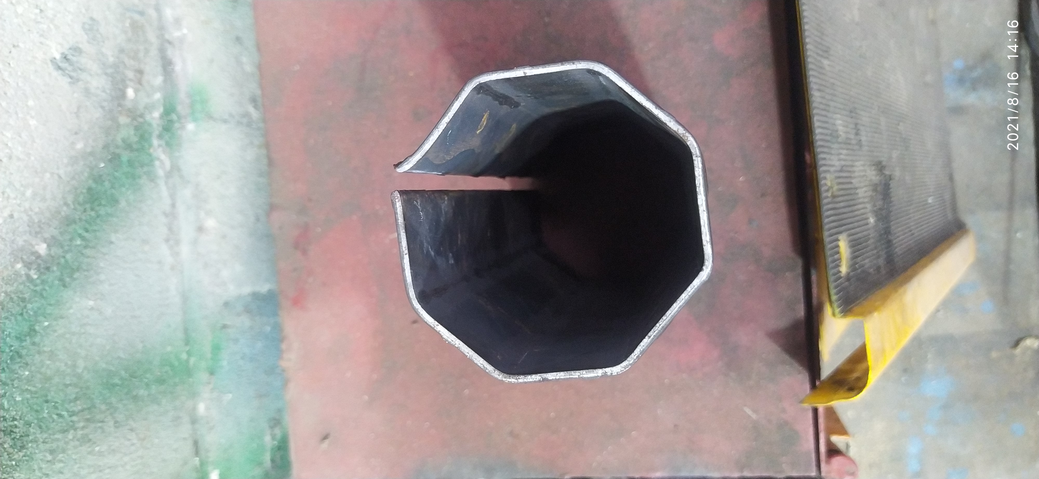

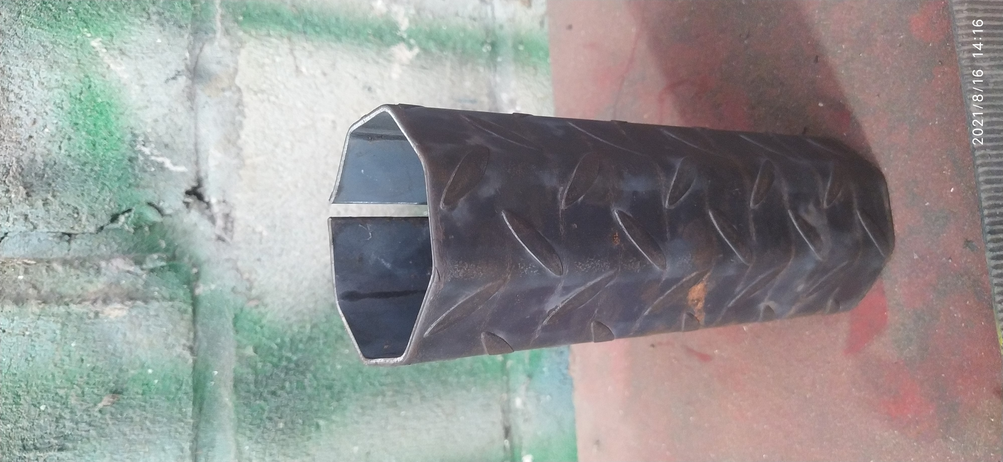

This is the result of bending, I tried to lower the x-axis first by about 3 mm.
