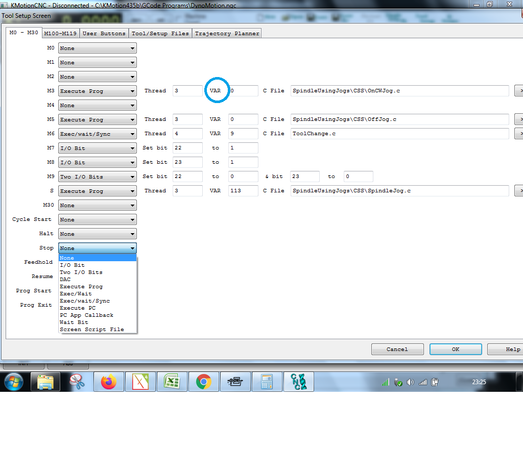

What are the uses of VAR?

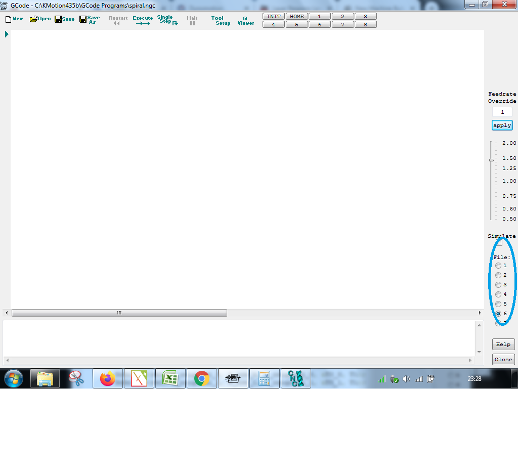

and how, in one program g code there are 2 files?
See here and here.
To easily switch between files. Please don't use KMotion.exe's GCode Screen. It is obsolete. Use KMotionCNC instead.

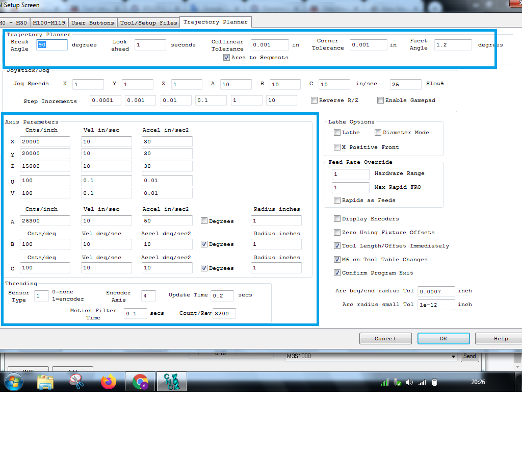

I do not understand how to fill / rate this. please show me how.
See here. You can get to a explanation of any parameter yourself with just 2 mouse clicks: click Help, click the parameter

about axis parameter:
for example in kmotion I use V = 700, A = 3500, J = 350000. what value should I set in KmotionCNC for the Axis parameter?

I mean, for multiple g code files in 1 program.
Can it ? and how?
does it have to follow the value in kmotion.exe?
see here.
Can it ? and how?
No, a GCode Program is one file.
