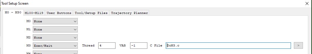

Your M3 Action is just setting a bit so of course it doesn't wait. Change it to a C Program with the wait in it.

I make i M3 handling c program "DoM3.c" which is called by M3 in KmotionCNC with an action Exec/wait.

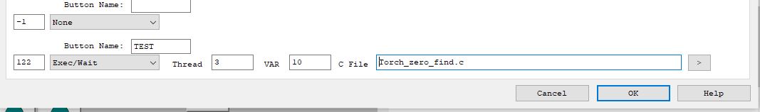

This is the Torch_zero_find.c which is called from user button 9 key 122, not as i wrote by mistake 116.
The DoM3 is called by M3 via action Exec/wait from KmotionCNC.

There is one problem with the Keypress. With a screen script its Action has priority and overrides the button action so the C Program isn't called.
Like I suggested before use:
			if (ScreenScript("Action:5;3;-1;0;0;0;Torch_zero_find.c"))
which issues the Action directly without the need for a button. When I posted that previously somehow spaces were introduced which causes it not to work.Maybe that is why you decided to do it differently than what I suggested.
