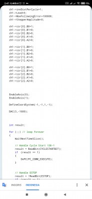

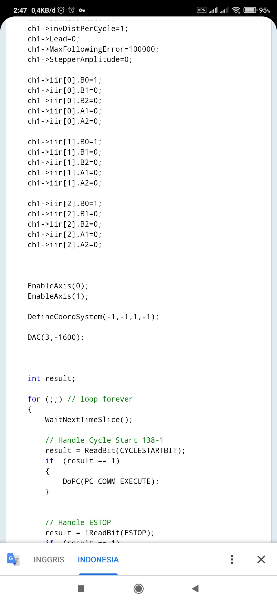

I have written above. please check?

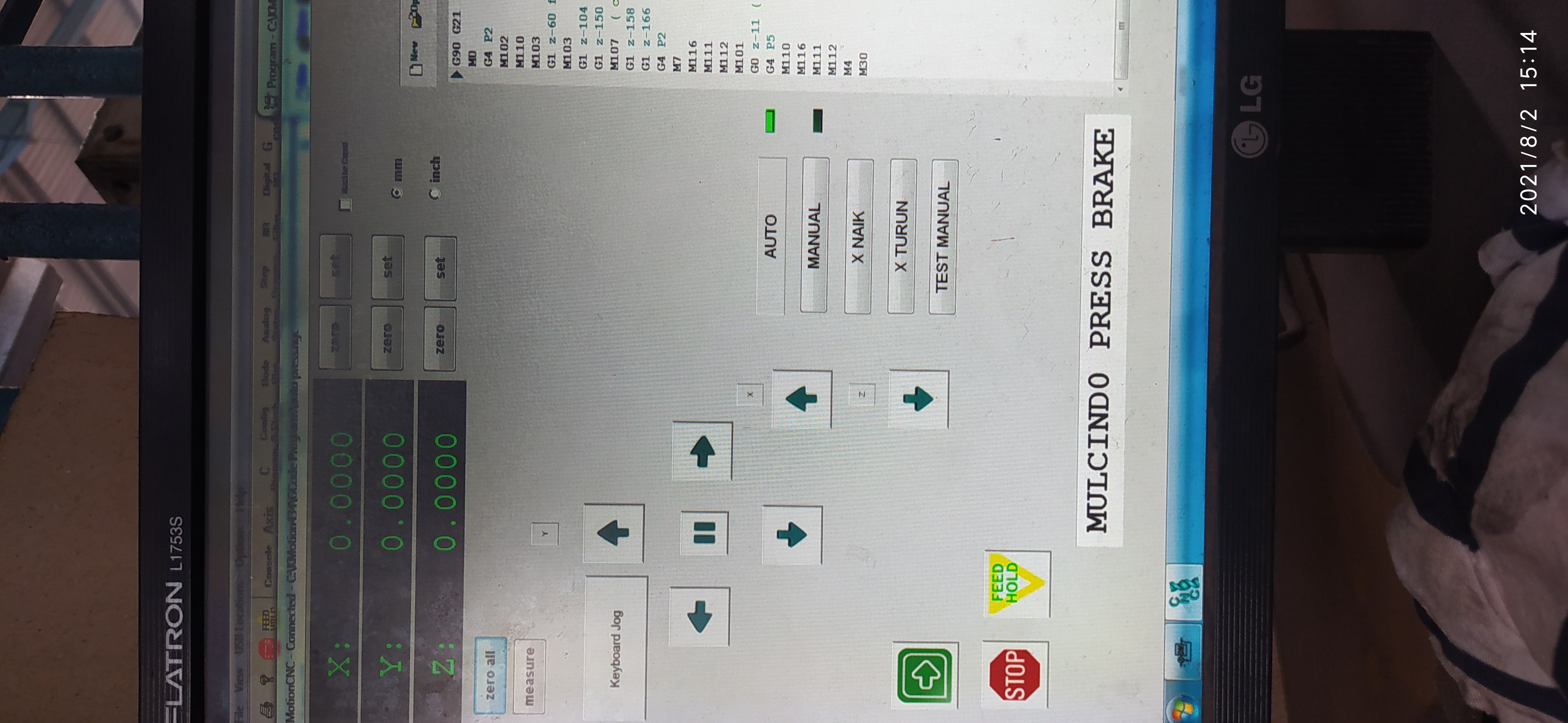

Post by irmad » Mon Aug 02, 2021 4:42 am
is there an example script c program for this video sir, this is very helpful.
for now, I haven't been able to make the X Axis readable in DRO.
i've tried to write DefineCoordSystem(0,1,1,-1);
but it reads only Axis Z or Y.
Axis X is slave and Axis Y/Z is Master.
then i try to move down the result only one axis (master) works.
is there a way to make X and Y readable on the KmotionCNC DRO, sir.
next question, how to write in c program for reboot command!, sir. because if I write it in console, it works. but not in c program. please give a solution.

Post by TomKerekes » Mon Aug 02, 2021 3:36 pm
There isn't any C Program needed for the demo in the video. You might see SetFROwithPot.c to see how FRO can be changed from a C Program.
Only Masters can be displayed or included in the coordinate system. It doesn't make sense to define an axis as an independent axis and to follow another axis as a slave at the same time.
You shouldn't need to do this, but you could define and call iReboot();
void iReboot(void);
iReboot();

Post by irmad » Tue Aug 03, 2021 2:39 am
just for indicators, sir. so that I can see the difference in distance between Axis X and Axis Y. so that I can synchronize and produce the same degree of bend.
