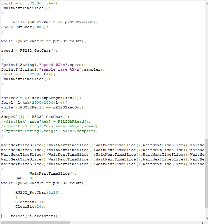

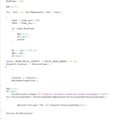

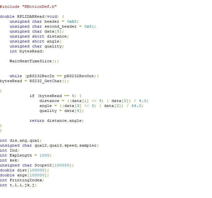

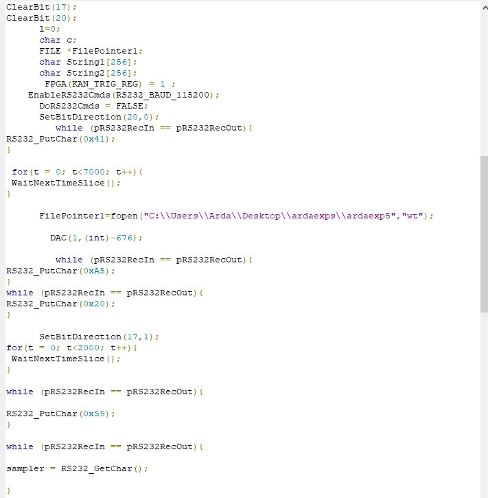

I am using 115200 as a baud rate. I changed code from the scratch and it did work for a while. After reseting device it started giving all zeros again. It happend twice so I have 3 codes that worked before but not working now. I don't have oscilloscope but i will find one. Also I want to add that old version of the code worked in the past as well. But it started giving all 0s after cutting power supply. Expected output is something like "A34C5" Here is the updated code: yeni 1.png, yeni 2.png, yeni 3.png Here is the older version of code: eski 1.png, eski 2.png

As I said 115,200 baud won’t work.
Post your programs with a description not images of your programs.
Indent your programs to make them readable.

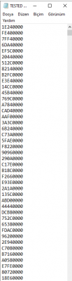

Now I am trying to establish communication again regarding your feedbacks. Serial communication test that i'm appliyng is added as a code below. As a result of thist test i am expecting outputs. Expected outputs are below as well as a jpeg file. I am getting all 0s instead of outputs. Am I missing something?

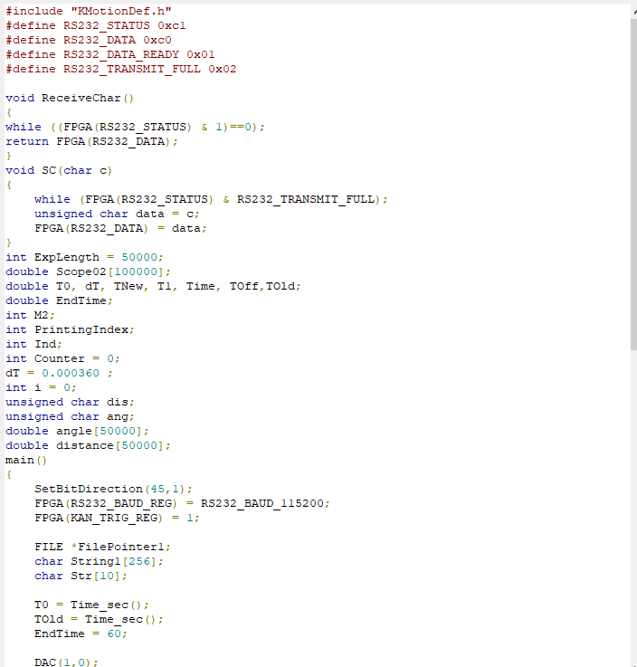

Snippet from expected Results are attached. Also I want to add that I achieved that succesfull and desired result by using code provided below. But after closing and opening system again my program never worked. Old Working program

#define RS232_STATUS 0xc1
#define RS232_DATA 0xc0
#define RS232_DATA_READY 0x01
#define RS232_TRANSMIT_FULL 0x02
void ReceiveChar()
while ((FPGA(RS232_STATUS) & 1)==0);
return FPGA(RS232_DATA);
void SC(char c)
while (FPGA(RS232_STATUS) & RS232_TRANSMIT_FULL);
unsigned char data = c;
FPGA(RS232_DATA) = data;
int ExpLength = 50000;
double Scope02[100000];
double T0, dT, TNew, T1, Time, TOff,TOld;
double EndTime;
int M2;
int PrintingIndex;
int Ind;
int Counter = 0;
dT = 0.000360 ;
int i = 0;
unsigned char dis;
unsigned char ang;
double angle[50000];
double distance[50000];
SetBitDirection(45,1);
FPGA(RS232_BAUD_REG) = RS232_BAUD_115200;
FPGA(KAN_TRIG_REG) = 1;
FILE *FilePointer1;
char String1[256];
char Str[10];
T0 = Time_sec();
TOld = Time_sec();
EndTime = 60;
DAC(1,0);
for (Ind = 0; Ind<ExpLength; Ind = Ind+1)
Time = Time_sec()-T0;
TNew = Time_sec();
if (Time>EndTime)
DAC(1,0);
SC(0x25);
break;
M2 = (int)(-675.8);
DAC(1,M2);
SC(0x21);
while((FPGA(RS232_STATUS) & RS232_DATA_READY) == 0){
Scope02[Counter] = ReceiveChar();
Counter = Counter+1;
WaitNextTimeSlice();
DAC(1,0);
SC(0x25);
FilePointer1=fopen("C:\\Users\\student\\Desktop\\arda\\ardaexp1","wt");
for(PrintingIndex=0;PrintingIndex<ExpLength;PrintingIndex=PrintingIndex+1)
fprintf(String1,"%X \n",Scope02[PrintingIndex+30]);
fclose(FilePointer1);

Were you able to change the transmitting device's Baud rate? Both sides need to be set at the same rate.
Please indent your code consistently and add comments explaing what you are doing. That's only a common courtesy if you are asking others to check your code for you.
KFLOP User Threads are basically limited to 64KBytes/Thread (code and global data). The Stack size (local variables) is limited to 2KBytes.
An Array like:
will use 8x100000 = 800,000 bytes. What is this needed for?
The gather_buffer is an array of 1 million doubles. You might use that if large arrays are required.
An Array like:
double Scope02[100000];The gather_buffer is an array of 1 million doubles. You might use that if large arrays are required.
