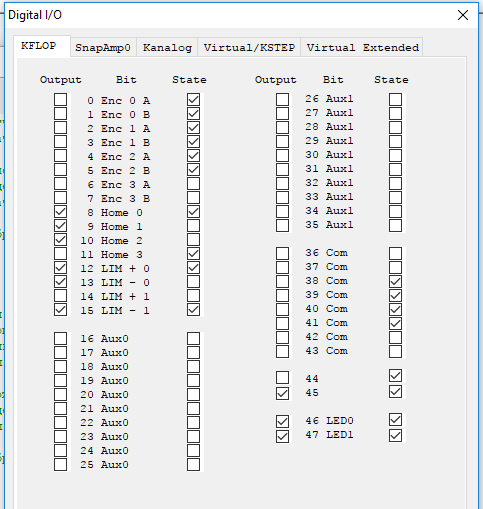

Hello everyone! Can't zero axes on Kflop+Kanalog board. I use virtual bits 36 and 37 of Kanalog Board JP2 terminals to zero axes by encoders' zero marks, but it doesn't work. SetDirectionBit(36,0) and SetDirectionBit(37,0) are announced. I've tried to use virtual bits 6 and 7 of JP1 terminal to zero axis and it worked, but I need them for another device. Kmotion version is 4.34j. Please help :!:

Bits 36 and 37 are not Virtual Bits. Those are real physical IO Bits. They default as inputs so it isn't necessary to set their direction, but it doesn't do any harm. When using Kanalog, KFLOP Bits 36 and 37 receive the differential signals connected to Kanalog JP2 A4 and B4. Do you have your Axis 0 Index Pulse wired to Kanalog JP2 pins 1 and 2? Do you have your Axis 1 Index Pulse wired to Kanalog JP2 pins 3 and 4? This is described here:
http://dynomotion.com/Help/SchematicsKa ... analog.htm
You will also need the RJ45 connection between KFLOP JP5 and Kanalog JP9 for this to work.

Yes, Axis 0 Index pulse connected to JP2 1 and 2 pins, Axis 1 Index Pulse connected to Kanalog JP2 pins 3 and 4.
When I wired Axis 0 Index Pulse to JP1 pins 13 and 14, Axis 1 Index Pulse to JP1 pins 15 and 16 and changed bits as nessesary for bits 6 and 7 it all worked.
Kanalog connected with kflop vith rj45 connection.

Is the RJ45 cable plugged all the way in insecurely? Does the RJ45 cable look damaged? Is it the straight through cable Dynomotion supplied?
You might test JP2 pins 1 & 2 by connecting an encoder channel. Then see if Bit 36 Toggles as the Encoder moves.
Or apply a fixed voltage such as 3.3V to + and GND to - to see if Bit 36 comes on. Then reverse to apply 3.3V to - and GND to + to see if Bit 36 goes off.

tried to check 36 and 37 pins as you wrote, it doesn't work

You might check KFLOP IO 36 and 37. Unplug Kanalog. Set IO 36 and 37 as Outputs. Toggle their state. Check if they change.
You might Flash New Version to remove any configuration changes or programs you might have made. Then power cycle and test before running any of your C Programs.
