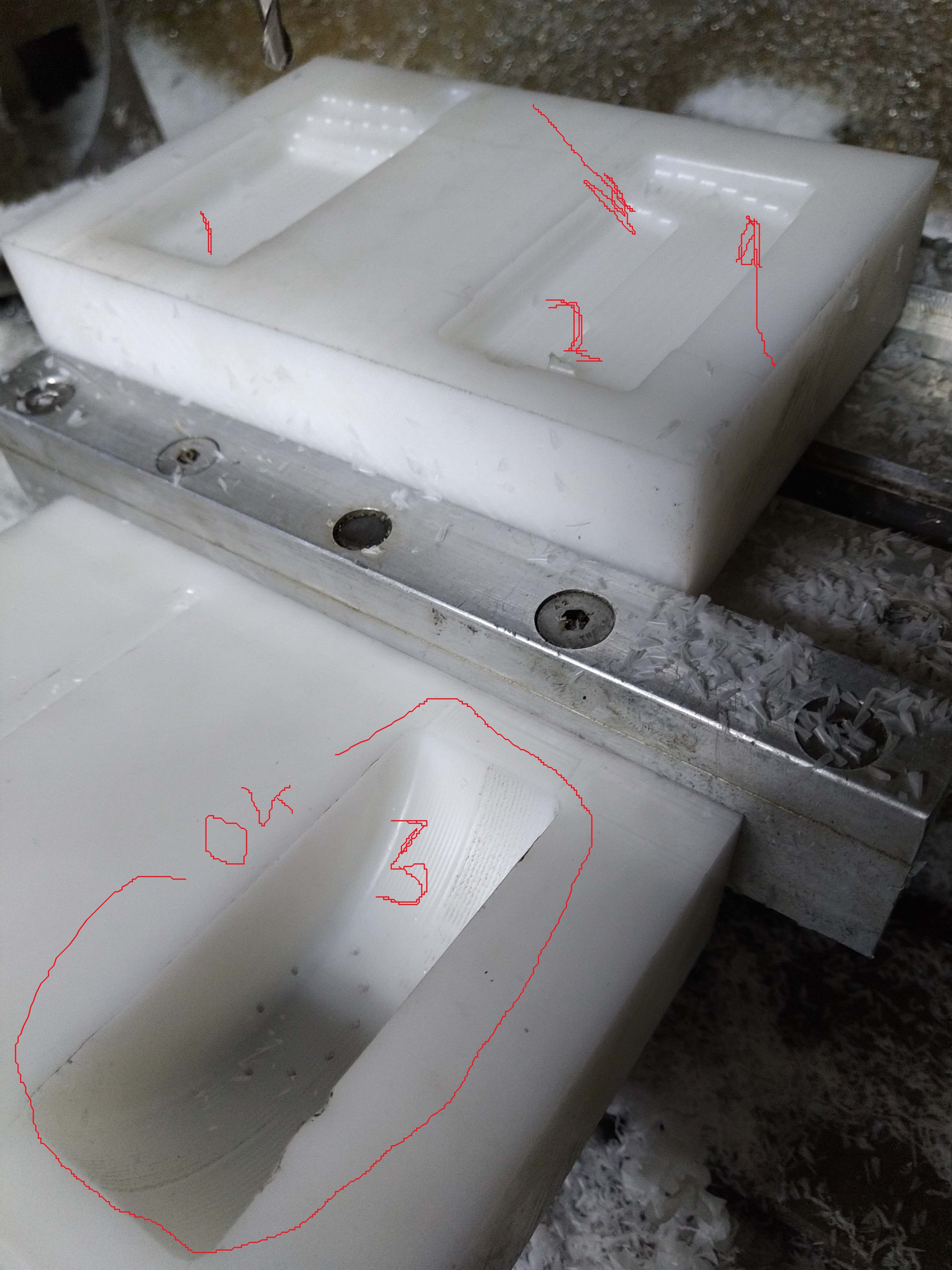

I have been using the Kflop KAnalog combo for a few years now (happy customer), I use Cut2D (Vectric) with the generic post processor (works great) to get my G-code. Now I've upgraded to VCarve Desktop (Vectric) to cut more complex shapes, the G-code looks very simple and clean (using same post processor I used with Cut2D).
So My first cut went well (item 3 in (Tray Mill wrong) pic) then I started to get this offset issue, X-axis zero (zero on the side of my work piece) value changes every time it steps down, item 1 and 2 in pic (Tray Mill wrong).

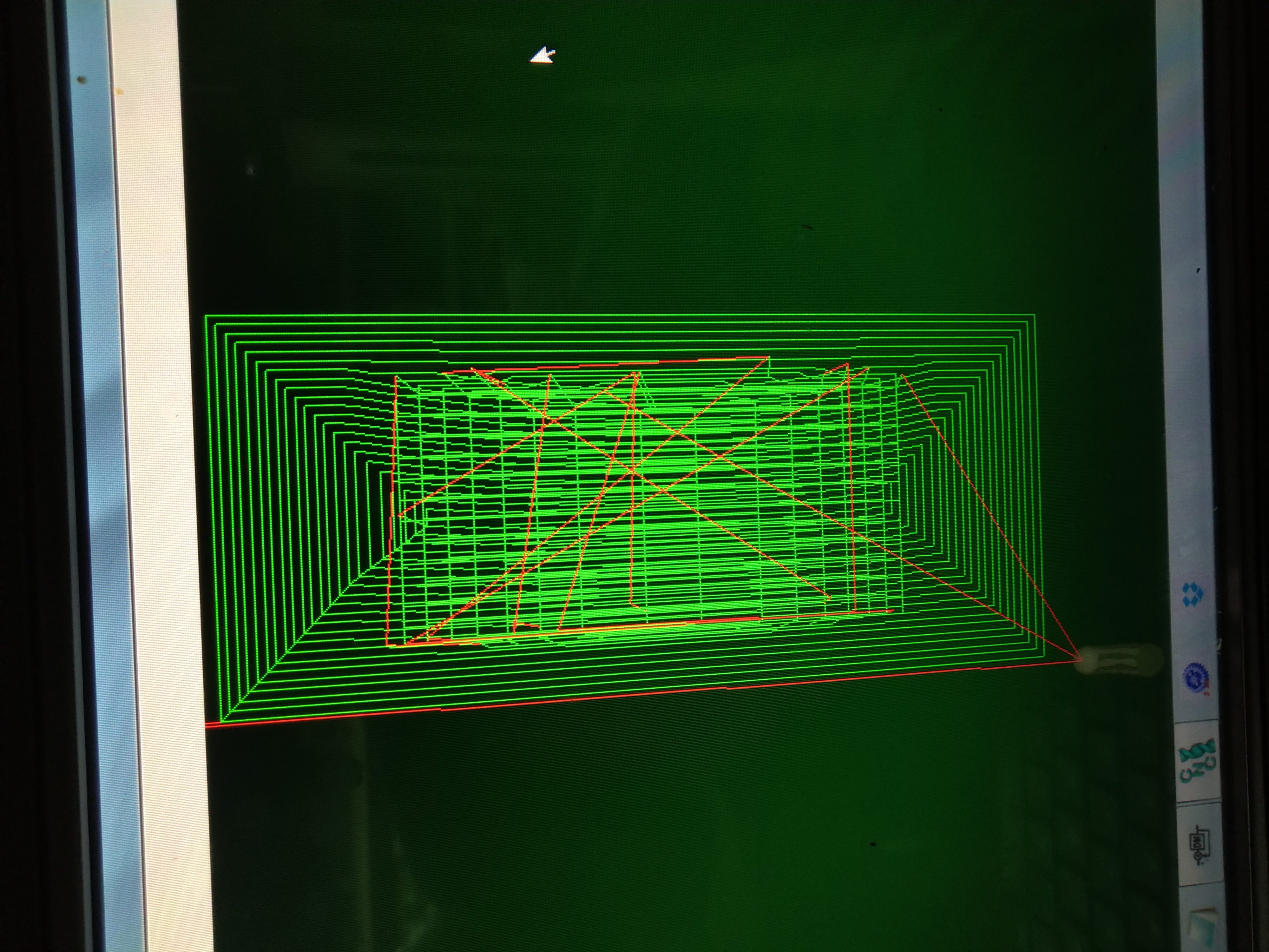

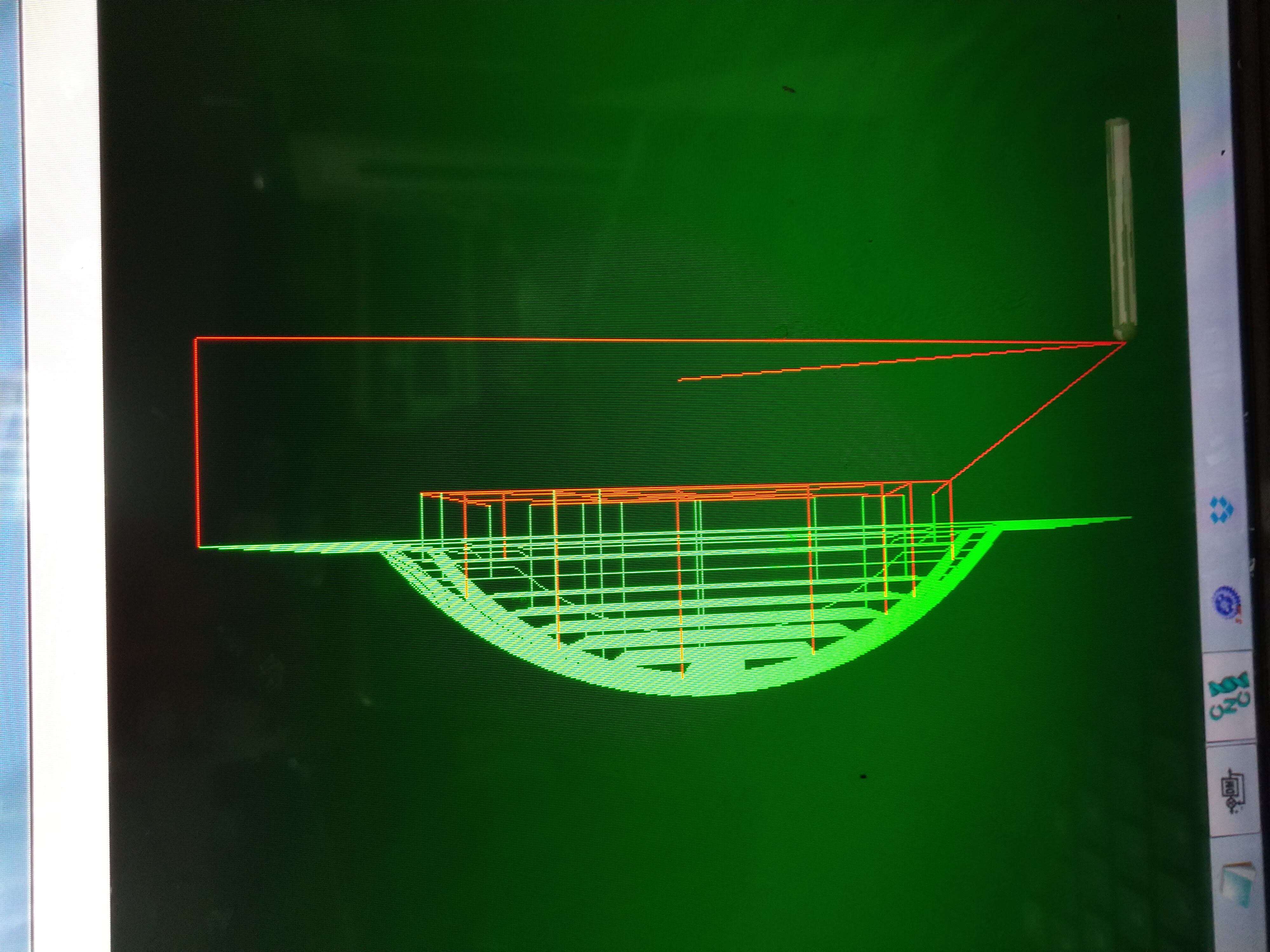

Kmotion can load the Gcode fine (see pics G viewer (Tray Tool path)).
