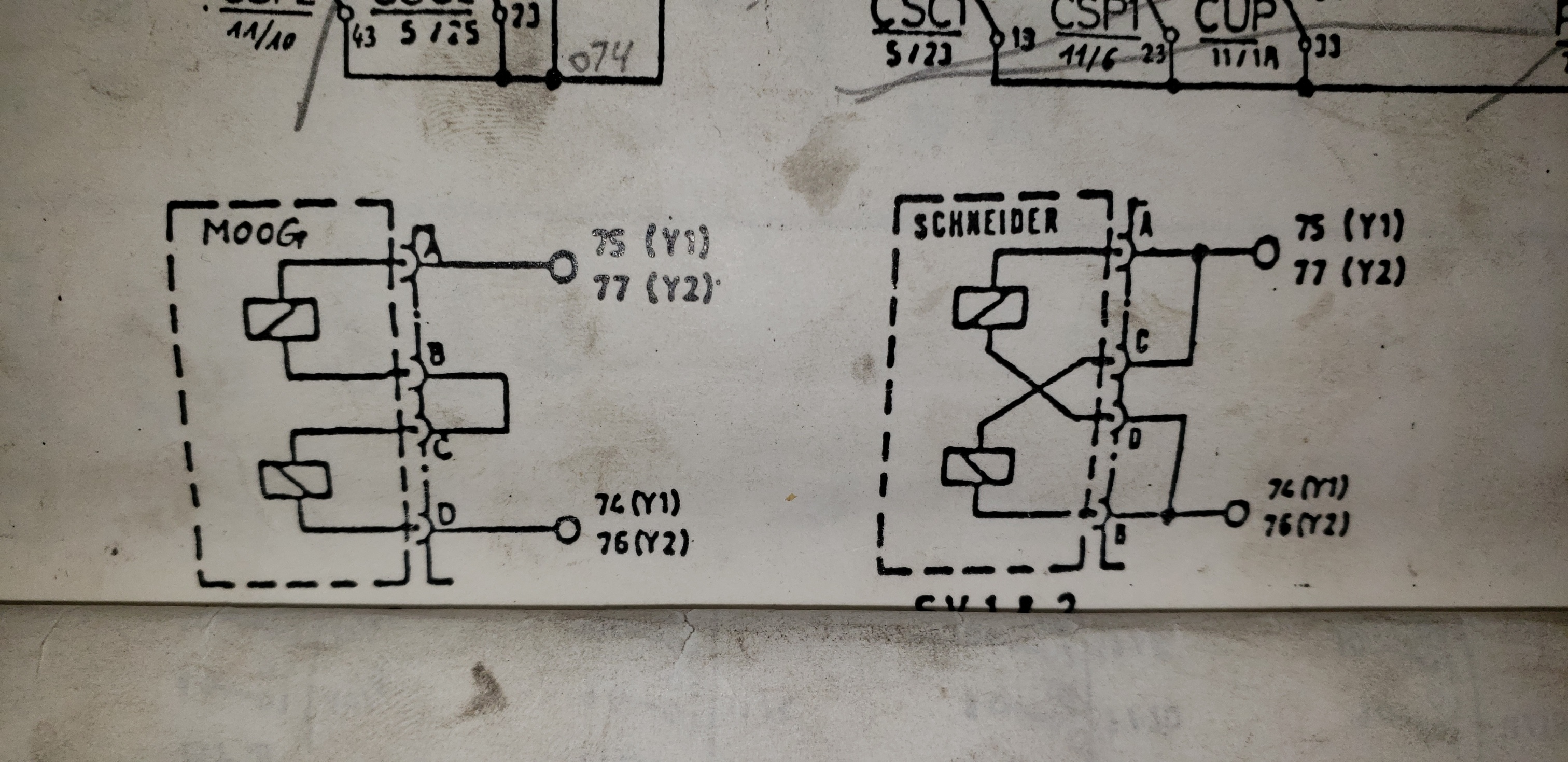

To my thinking the valve solenoids are tantamount to linear motors, albeit very short stroke (0.060 spool movement). Each servo valve has only one bi-polar solenoid (opposing coils wired internally in parallel) which seem to be activated together in a push-pull arrangement as the current changes. This regulates a pilot circuit in the valve so the total solenoid force (current) needed for actual machine motion is much less.
I don't follow how the opposing coils would work, but anyway I would expect it to work. Feedback from the encoders would vary the output to somehow control the speed and position.

The solenoid coils have from 17 to 25 ohms of resistance if I remember correctly. I will have to learn about the PWMR mode also. I have enclosed a picture of the coil schematic - I have the Schneider servo valve on the right. It somewhat shows the relationship of the coils and how they are opposed electrically with only 2 leads going to the control. https://www.dynomotion.com/forum/downlo ... iew&id=562
Again, thanks for your guidance.
