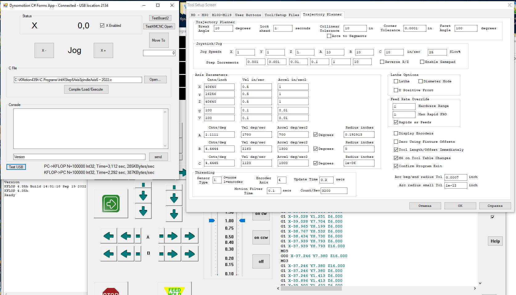

Good afternoon Tom, happy NEW YEAR))). I have a similar problem, randomly kflop turns off, after rebooting wine 10 it connects, but also not every time. the LEDs blink when there is no connection, are there any other recommendations and how to fix this problem? and now i'm running into an even weirder problem, my init file refuses to "work" when i plug in external power (molex). the problem looks like this. when connecting an external power supply, the X-Z-Axes do not take hold. the Y-axis works, the A-axis rattles, oscillating in different directions. only 4 axes are physically connected at the moment. 4 axis A rotational (turning).

1 loses connection with computer. 2 yes usb 3 yes windows 10. 4 no connection only to cflop. I made many attempts to fix this problem, but alas, I myself went to a dead end. changing the conclusions on the motors to TTL. I got that the linear axes work. but rotations don't work.
