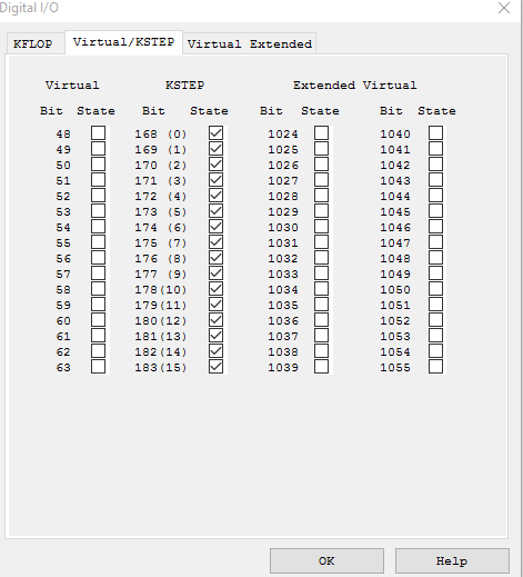

3. Checked the status of the digital Inputs using the Digital I/O screen and found that all inputs in KSTEP are shown as active
(ie check box marked)

(2) Run our test C code (refer attachment) and then checked the status of Digital Inputs and found all the inputs to be active
==> without even we grounded any of the inputs

- Screenshot of KStepDigital Inputs, when we enable KStep

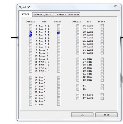

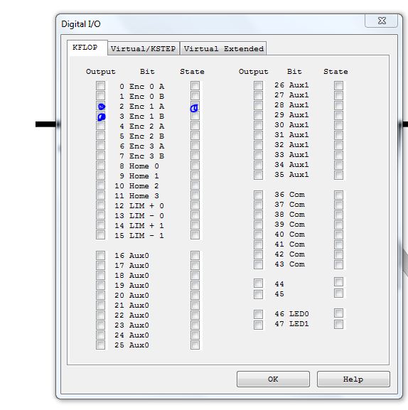

Apologies , not sure why that attachment is missing, will attach tomorrow from my test bench. We noticed that the KFLOP bits 2-3 status were toggling in Digital I/O screen and output status were enabled. Please refer this attachment colored by me to show the happenings.
