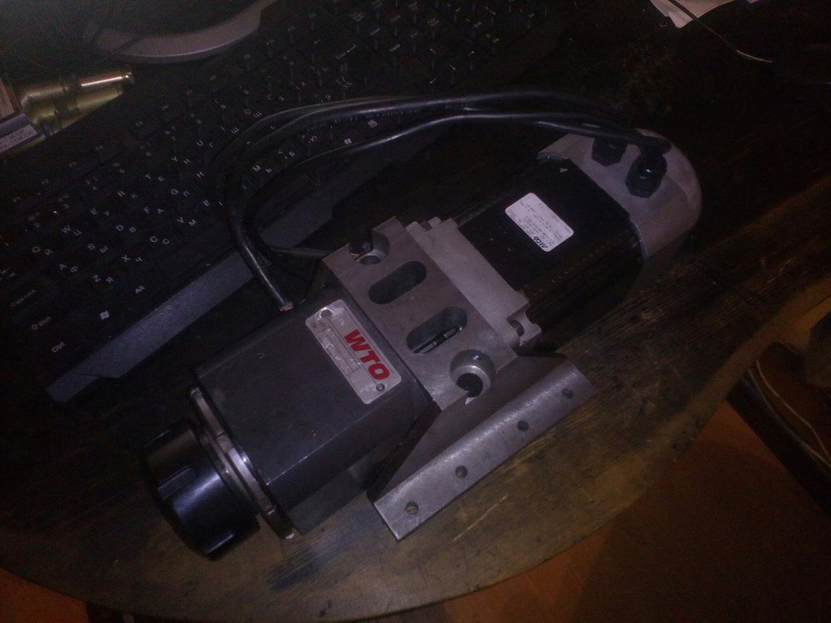

Hello! I'm collecting the machine. I will connect the encoders, so I decided to buy KFLOP. The axles are controlled by step/dir. Spindle with analog control. I bought a PWM conversion board in 0-10V. (a photo). If I still understand in the electrician and can disconnect the wiring, then in programming, a full zero. I ask for help on correct adjustment of spindle control!

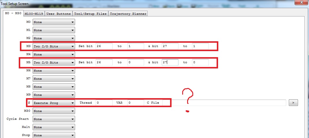

I want to use to adjust the spindle speed
JP6 IO26 Gen Purpose PWM0 out
I want to use to turn the spindle on and off.
JP6 IO27 Gen Purpose LVTTL I/O 3.3V

I will turn on and off through the standard M code.
IO27 will be connected to the optocoupler, and it will command the servo amplifier S-ON/S-OFF
I do not understand why I need an analog output 5V. when it needs 0-10V.
And how you can change the spindle speed.

Hi Lafayette
I don't think you told us about any optocoupler or what interface the amplifier has. Assuming IO27 can be interfaced somehow to turn the Spindle on and off then you probably don't need a C Program for M3 and M5. Just configure those to operate IO27.IO27 will be connected to the optocoupler, and it will command the servo amplifier S-ON/S-OFF
That was intended to only be a simple test to output 50% to see if the hardware is connected properly and is working. You can change the value of 128 to other values to test other voltages.I do not understand why I need an analog output 5V. when it needs 0-10V.
Later you can use a C Program similar to the the one used for KStep's on board PWM to analog converter for the S Action. See the example Spindle_S_Kstep.c. Note the CorrectAnalog() function will probably need to be modified for the nonlinearities of your converter which is likely different than KStep's. If low speed control is not critical no changes may be needed. See:the Analog Output Section Here.And how you can change the spindle speed.
