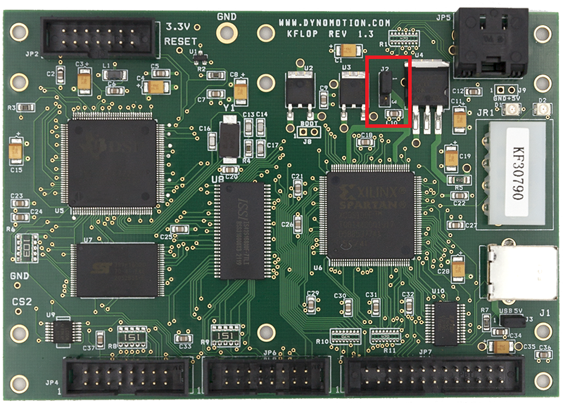

Thank you soooo much, Tom! The problem comes from the J2 jumper. I forgot to check J2. Thank you again.

My apologies I forgot there is Jumper J2 which can change a number of IO pins to operate with a 2.5V supply instead of a 3.3V Supply. Or if not installed basically no supply at all. It should be installed as shown below between pins 1 and 2. I think this is the issue. I see in your email/post this was in fact the issue.
