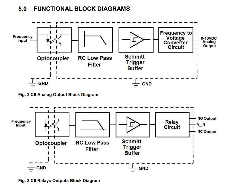

Next will be interfacing my Kflop with the inverter through a C6 interface board. There was a pretty good post on how to do that so I'll start there and see how far I get.

You might also use the IO on KStep which is fully isolated.Next will be interfacing my Kflop with the inverter through a C6 interface board. There was a pretty good post on how to do that so I'll start there and see how far I get.

Yes, I was going to use JP26 for CW/CCW and Speed

I have my spindle starting and stopping from Kflop JP5. When I switch to Kstep JP26 I get nothing. I read that I have to enable the amplifiers on Kstep. I have separate 5volt supplies for Kstep and Kflop. Do I connect a jumper from Kstep JP6 enable to Kstep 5v? Kstep Ground? or Kflop Ground?

How can you do this? KFLOP JP5 have Step/Dir LVTTL outputs. JP26 has no Step/Dir outputs and has relay driver outputs (basically switches). Totally different.I have my spindle starting and stopping from Kflop JP5. When I switch to Kstep JP26 I get nothing.
That's for the Stepper Motor Drivers not JP26 IO.I read that I have to enable the amplifiers on Kstep.

Well I guess that explains a few things. I saw Step and Dir on JP26 and assumed that I could use those points to drive my spindle. I misunderstood the documentation.

So back to an earlier response from you when I said I wanted to control a spindle you suggested "You might also use the IO on KStep which is fully isolated." Where/how would I do this? or should I just leave well enough alone and stick with JP5 (I/O 39,40 & 41)?
