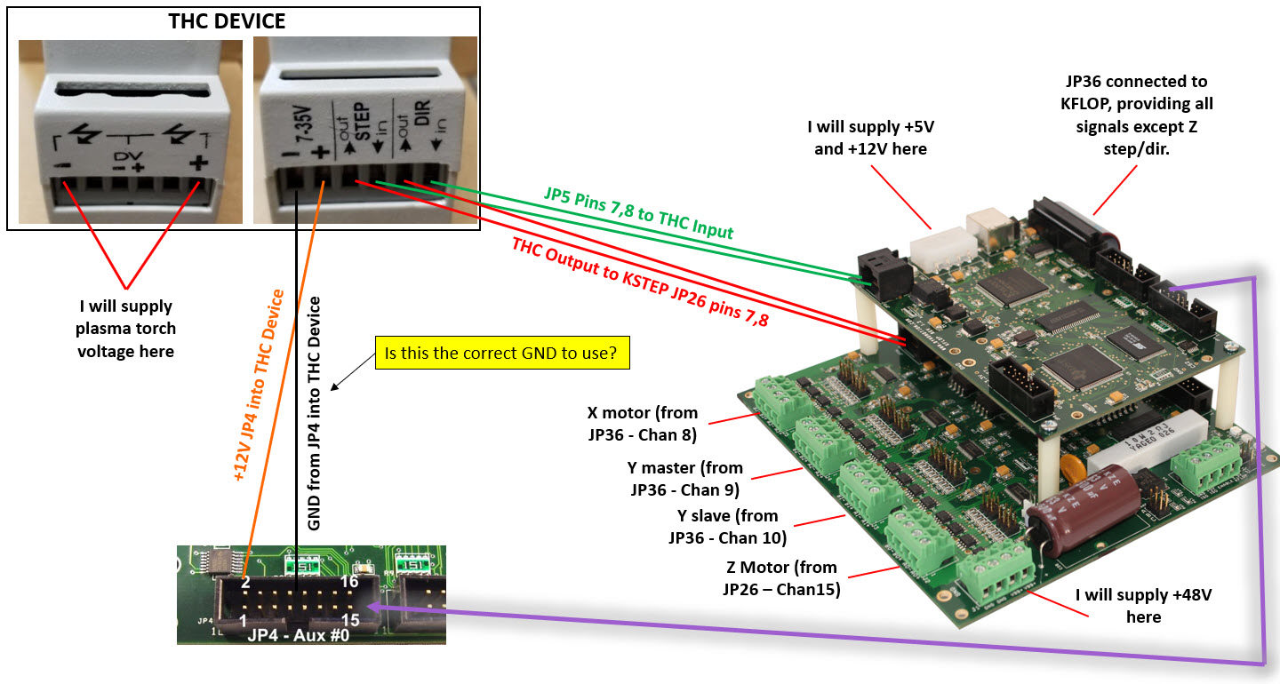

I don't know if you can call the below a wiring diagram, but I think it gets the point across of what I am thinking about doing. In addition (not in above image) I want a method of bypassing the THC that can be toggled via custom MCode in KMotionCNC. The 2 methods I think would be easiest to do this would be:
1.): put an IO pin triggered relay controlling the torch voltage connection to the THC.
- this is the easiest option, but not preferred because I couldn't view the voltage the THC is reading during the cut.
2.) put IO pin triggered relays controlling the step/dir signals connection to the THC
- this is preferred from a use case standpoint, but I don't know if interrupting the Step/Dir inputs via relay will cause issues with noise or cause the motor to jerk/etc.

Ahh I didn't realize the plasma device switches between pass through and driving the signals.
Regarding method #2 - Yes if using a mechanical relay there may be some glitch steps when switching the signals with a relay. I'm assuming you are thinking like a DPDT relay to switch the KStep Inputs from the plasma device outputs to the KFLOP outputs. I think it should work reliably if the Step signals are low when it is switched. Direction shouldn't matter if it glitches as long as there are no step pulses. KSTEP inputs are basically an LED that needs to be driven high with power to turn on. If the KFLOP output is low and the Plasma output is low then switching back and forth or going open circuit should result in the LED remaining off.
