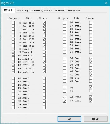

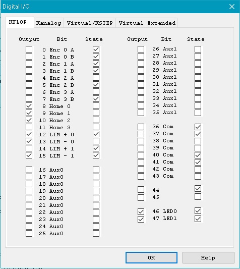

So even though the Digital I/O KFLOP page shows bits 8-15 as Home and Limits, they are connected to encoder channels on my board.
What's confusing is that when I click Reboot! in the KMotion Console, I find that the Output check boxes change to how they appear on the attached Digital IO.JPG screen shot.
Why do bits 8,9,10,12,13 & 15 all revert back to outputs after a reboot? How can I force them to stay set to Inputs?

If I reboot and leave the KFLOP bits 8-15 as they are set by that (see the screen shot on my first post) then KMotionCNC will initialise and the jogs work on X,Y & Z
However, if I uncheck all of the output check boxes, it doesn't work any more. There appears to be some conflict between what KFLOP is using those bits for and what KANALOG is using. My guess is that they're assigned to two different things that you can't use at the same time.

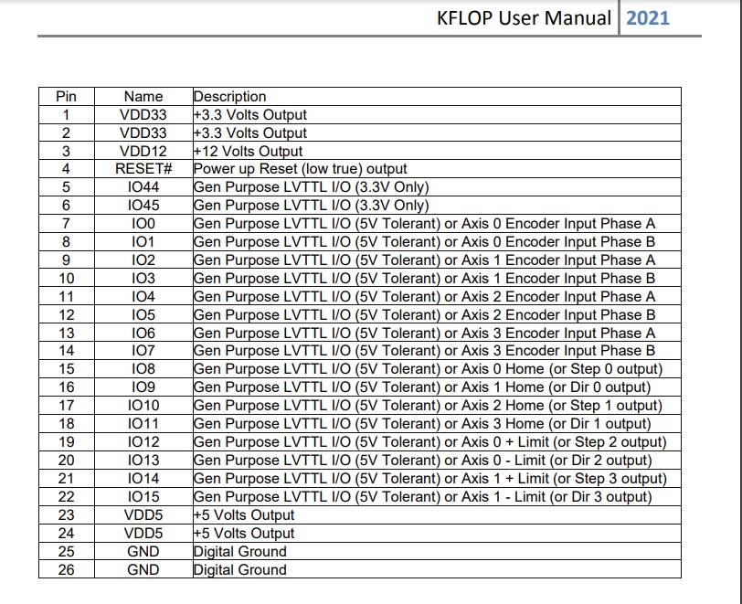

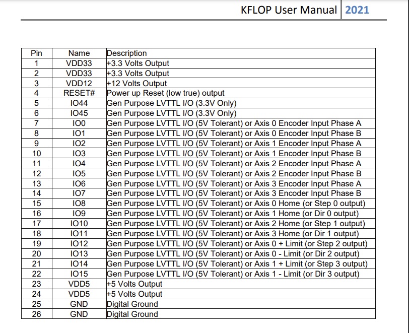

Looking again at the KFLOP GPIO JP7 pin assignments (see attached screen shot), it seems to me that the conflict is that I'm using the alternate Step & Directions on the Auxiliary ports, and that should free up the pins IO8-IO15. My guess is that although the Step & Direction outputs are being correctly routed to the Auxiliary ports because they work, KFLOP doesn't correctly disconnect them from the pins on JP7 which should be free to use the alternate functions listed on the connector.
This would explain why it doesn't jog any more when I force the outputs to be inputs. It looks like those disable the outputs on the auxiliary connectors which I'm using as outputs. In other words, the direction check boxes for KFLOP pins 8-15 seem to be shared with the ones oncthe auxiliary connectors. Those should be separate in my opinion, since you ought to be able to have the Step & Direction outputs on the auxiliary port and their alternate pins on the GPIO port being inputs.

When you say to "Flash New Version", I presume you mean to press the NEW VERSION button in the Configuration window. That offers me a file called DSPKFLOP.out which is dated 14/8/2018 so I used that one. This made no difference.
