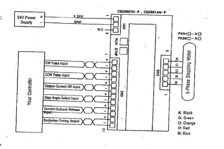

My Motor driver has differential STEP/DIR/HALF STEP/WINDINGS OFF/CURRENT CUTBACK inputs.
So, what boards do I need for that? Do I need an analog board for the drivers differential inputs (KFLOP outputs)? From reading the documents one can mirror pins and some have different function when board "X" is installed. I think about the analog board which has a large connector and might block some IO's. Does it add inputs or does it limit the digital IO's?

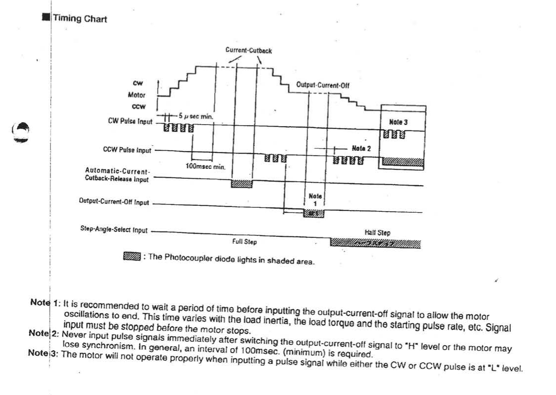

I attached some images. The encoder is a KOYO TRD-3A1024-2610. So it has 1024 positions per 360°.
I have no manual,I assume the outputs are Open Collector type.
The driver is from Vexta (CSD5807N-P)
http://site.motadistribution.com/manual ... manual.pdf

The drivers have differential inputs. What card combination do I need to have differential outputs on KFLOP?
KFLOP (or any of our option boards) do not have differential outputs. The drive's inputs are basically an LED so you probably don't need differential drivers. KFLOP's 5V open collector mode would drive them.
But unfortunately the Drives Specify CW/CCW pulses of 5us minimum. KFLOP's pulses are a maximum of 3.78us. So they are incompatible and probably won't work reliably. The only way to make them compatible would be to add an external pulse stretching circuit.
