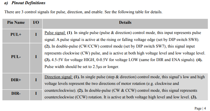

I want to interface a new hardware with KFLOP, that is leadshine close loop step servo CSM22430 and Drive CS-D508,
Please guide me through the steps and it is required to set pulse width more than 2.5uS in above drive but klfop having only 2uS, how to change that too.
link is in the description.

Hi Amit,
FPGA(STEP_PULSE_LENGTH_ADD)=63; // set pulse size to 3.78us
FPGA(STEP_PULSE_LENGTH_ADD)=63 + 0x80; // set pulse size to 3.78us and invert pulse
This is described here in the manual.
Because that Drive supports CW/CCW pulse mode it would be best to use that instead of Step/Direction as it avoids any Direction setup timing requirements.
To set maximum pulse size use one of the following:Please guide me through the steps and it is required to set pulse width more than 2.5uS in above drive but klfop having only 2uS, how to change that too.

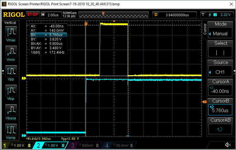

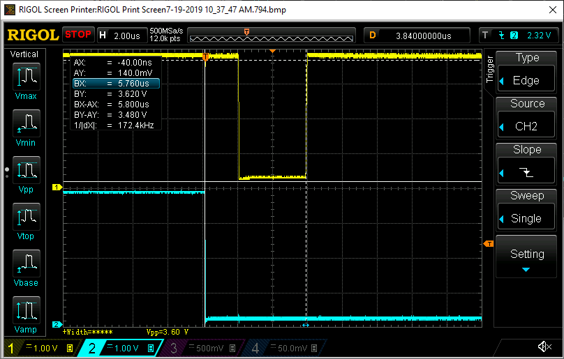

Dear Tom,
1. As per the Driver manufacturer datasheet, Minimal direction setup should be 5uS, but in KFLOP don’t know the default value. So, Can we change the DIR setup time to 5uS in the KFLOP? How?
2. Kindly advice, what happens if we run with 4uS even though Driver DIR setup time specification was 5uS? is this wrong thinking?
3. As per the driver specification, supply Voltage for the PUL and DIR should be 4.5-5V for HIGH and 0-0.5V for LOW (mentioned on page 4 of the manual,PFA link). But We have measured the voltage (using Multimeter) on driver pin PUL+ with respect to PUL- is: 1.29V(No operation/maybe on low pulse), while motor running: 1.43V (1200RPM), 1.52V(2080RPM).
And Voltage on driver pin DIR+ with respect to DIR- is: 4.06(When No operation and Anticlockwise rotation), 1.3V (when the motor rotates in clockwise).
We are supplying a lower voltage than the required voltage for the driver PUL and DIR, right? Is there any issue? If I am wrong, kindly correct & advise.

Hi Amit,
KFLOP sets the Direction output 1.92us before generating a Step Pulse. With the maximum Step Pulse length of 3.78us the maximum Direction Setup time to the trailing edge of the Step Pulse is 5.7us.
Also from my previous post:
KFLOP should drive with >4V when sinking low and < 1.4V when floating "open". This does not meet the Leadshine Specification. But usually works as most any opto LED will need 1.4V or more to turn on. The open collector outputs on JP4 and JP6 do not have 47 Ohm series resistors as JP7 does so should drive with > 4.5V
If you need higher/lower voltage levels you will need to add an external driver. A differential line driver such as this should work well.
From the link to the manual I sent:As per the Driver manufacturer datasheet, Minimal direction setup should be 5uS, but in KFLOP don’t know the default value. So, Can we change the DIR setup time to 5uS in the KFLOP? How?
Insufficient Direction Setup Time can cause the Drive to make one microstep in the wrong direction after any change in direction. This will cause an intermittent shift in position of 2 microsteps. Again use CW/CCW to completely eliminate the issue.2. Kindly advice, what happens if we run with 4uS even though Driver DIR setup time specification was 5uS? is this wrong thinking?
You can not measure microsecond Step Pulses with a multimeter. You would need to use an oscilloscope. But they should be similar to what you measure on the Direction Signal.As per the driver specification, supply Voltage for the PUL and DIR should be 4.5-5V for HIGH and 0-0.5V for LOW (mentioned on page 4 of the manual,PFA link). But We have measured the voltage (using Multimeter) on driver pin PUL+ with respect to PUL- is: 1.29V(No operation/maybe on low pulse), while motor running: 1.43V (1200RPM), 1.52V(2080RPM).

- Posts: 2951
Re: Kflop Wiring for Leadshine Close loop step servo CSM22430
Hi Amit,
(Driving a 1.5K pull up to 5V)
Here is FPGA(STEP_PULSE_LENGTH_ADD)=63+0x80; // set the pulse time to 3.78μs and inverted
KFLOP's Direction Setup time is fixed at 1.92us. If the Drive is configured to step on the end of the Step Pulse then the total Direction Setup Time will be 1.92us + Step Pulse Time.1. I thought STEP pulse and Direction setup configurations are independent, we can configure both individually like Step Pulse 2.5uS with Direction setup 5uS. So my understanding is wrong?
Correct.2. If I want to change the Direction setup to 5.7uS, we should configure the step pulse to 3.78uS right?
Correct3. So we don’t have an option for configuring the Direction setup without configuring the step pulse width right?
Here is FPGA(STEP_PULSE_LENGTH_ADD)=63; // set the pulse time to 3.78μs4. Kindly advice the difference between 32 and 32+0X80, because we do not understand “pulse the Step High / invert pulse”.could you Kindly provide the graph for both the cases in details including the voltage/pulse width/etc for better understanding.
FPGA(STEP_PULSE_LENGTH_ADD)=32; // set the pulse time to ~ 2μs
FPGA(STEP_PULSE_LENGTH_ADD)=32 + 0x80; // set the pulse time to ~ 2μs and pulse the Step High / invert pulse
No, because all KFLOP IO have protection diodes connected to the 3.3V Supply.5. Why <1.4V when KFLOP pin is floating open? Why not it 0V? Because of the 47 ohm resistor?
