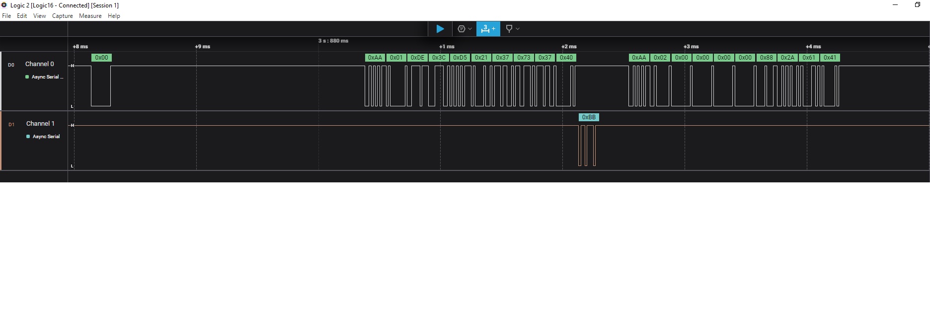

I encountered strange behavior of UART when sending data from KFLOP.
I'm trying to send two doubles(double a=23.45006, b=9e6;) using the SendDouble.c program, 2ms before the start of the exchange, 0x00 flies over the bus and ends up in the receiver buffer, how can I fix this?
In this screenshot, exchange with STM32

Hi Alex,
That should only happen once when the UART is first initialized to flush the output buffer. It shouldn't be a problem if the receiver ignores data until a STARTCODE (0xAA) is received.
