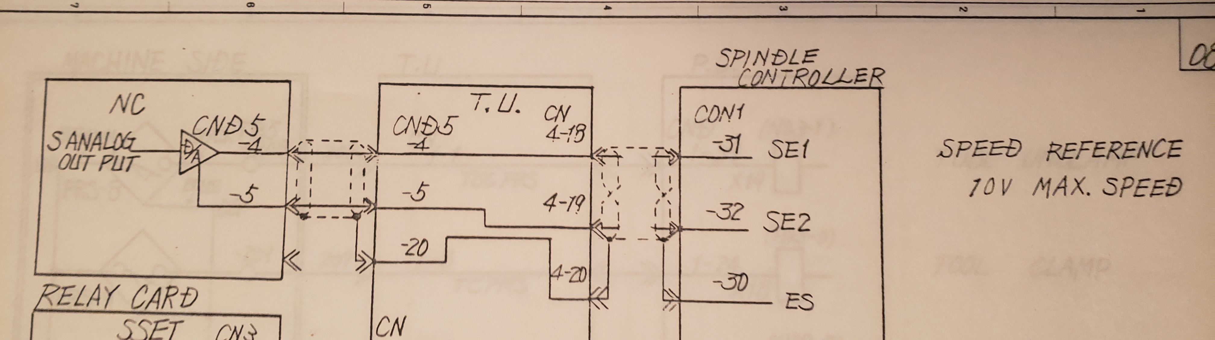

Hello,
I'm working on figuring out all of the pins that I need to connect on my mill, and I came across the spindle speed control which I don't really understand. It says it's 10V max which is nice since it can plug directly onto a Kanalog DAC pin. I've removed the Numerical Control(NC) unit. The TU is just a box that routes individual wires between different cables. I'll be connecting to the CND5-4(SE1), and CND5-5(SE2) wires.
Should I connect the CND5-5(SE2) wire to ground, and connect the CND5-4(SE1) pin to a DAC pin?
The Kanalog HW specifications webpage says +/-10V at 10mA. I can't find anything that says how much current the spindle controller uses. Should I put a follower op-amp in between the the DAC pin, and the spindle controller just to be safe? If it won't damage the Kanalog DAC pin I don't mind trying it directly, and then adding the op-amp later if it doesn't work.
For the solid state relays(SSR) I've seen other posts on here where it was suggested to just try 5V to drive them. It looks like the SSR gates are driven directly from the old NC unit on my machine. Is it a pretty safe bet that these old controllers were driving those gates with 5V and not 3.3V? The machine is down so I can't test them.

Seems correctShould I connect the CND5-5(SE2) wire to ground, and connect the CND5-4(SE1) pin to a DAC pin?
It would be very unusual for an analog input to need more than 10ma. Kanalog analog outputs are very robust and have short circuit protection (one at a time).The Kanalog HW specifications webpage says +/-10V at 10mA. I can't find anything that says how much current the spindle controller uses. Should I put a follower op-amp in between the the DAC pin, and the spindle controller just to be safe? If it won't damage the Kanalog DAC pin I don't mind trying it directly, and then adding the op-amp later if it doesn't work.
Hard to say. Another option would be to use Kanalog Opto Outputs to apply 5V or other voltage.For the solid state relays(SSR) I've seen other posts on here where it was suggested to just try 5V to drive them. It looks like the SSR gates are driven directly from the old NC unit on my machine. Is it a pretty safe bet that these old controllers were driving those gates with 5V and not 3.3V? The machine is down so I can't test them.
