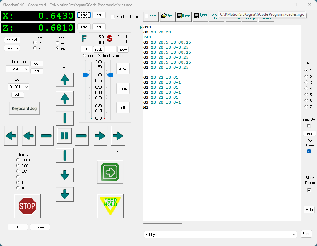

From where can i get the screen script for basic 2 axis lathe. I'm beginning to understand how screen editor works and want to assign hotkeys.
Sahil
Posts: 2891
Re: Kflop machine operator panel ?
Post by TomKerekes » Mon Jun 23, 2025 2:04 am
Hi Sahil,
I created it for you. See attached.
