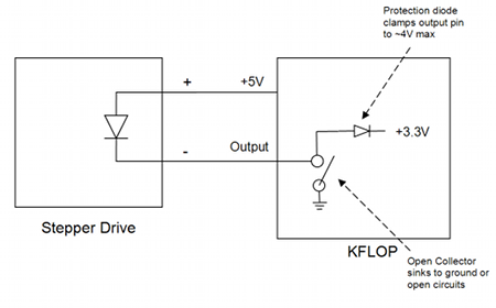

Checking to see if anyone has had good success with Leadshine stepper drives. I am using 6 closed loop mode with encoder feedback directly into the KFlop. I am looking a the model below and see that the voltage requirements are:
"Direction signal: 5V signal, differential input. High input is 4-5V, Low input is 0-0.5 V. Minimum pulse width = 2.5 µs"
https://www.automationdirect.com/adc/sh ... ves/dm556e
These are going into an OEM machine, and I am looking for the best reliability possible.
In the past I have used KStep boards in "CL Step" mode. I would like to keep doing this but Leadshine has "Anti Resonance" features built into the drive.
So Three Questions:
1. Would I have the best luck running on "Open Collector - Step/Dir" or "LVTTL - Step/Dir" mode?
2. No need for the IR filter anymore because leadshine is taking care of resonance? This would mean deleting all of the IR filter values when configuring the axis?
3. Anything else I should be considering when using a 3rd party stepper drive with the KFlop closing the loop with an encoder?
