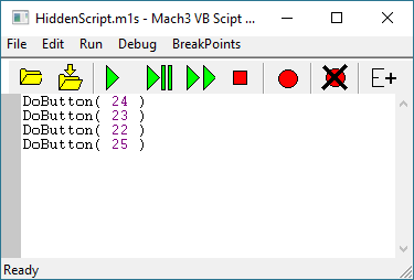

I think you will need to modify the Button Script for the REF ALL HOME button.
From the Mach3 menu | Operator | Edit Button Script | Then click on REF ALL HOME.
Button 27 is probably the Ref C button

I discovered a good work around (before receiving your reply).
I added code in the HomeEncoderMach3 program to also reference the C axis whenever the 'ref A' button is pressed.
This allows me to reference each axis separately using buttons on the Diagnostics page and all simultaneously using the 'Ref All Home' on the home page.
If your suggestion works (and I'm sure it will), I will reverse my code edits....
