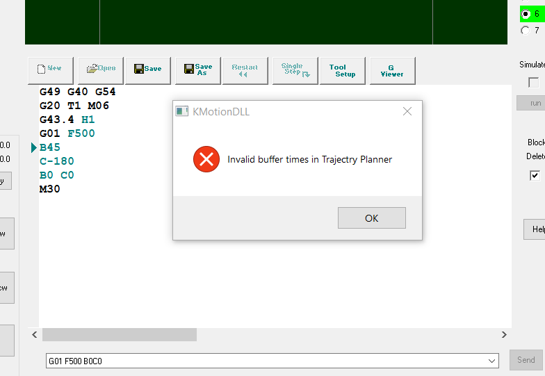

I ran my Test RTCP program and came up with a buffer error when program hit B45 line. I don't have any zero fields other than radius inches field.

Hi Tom , just playing with RTCP and the tracking problem is when the machine is running rapid G00 mode. In Go1 it tracks properly using MDI mode.
Still have the buffer error when trying to run simple RTCP test program.

Also any Idea why I am getting the buffer error?
We had that issue before regarding pure angle moves and applied a patch. Has that patch been applied in the code you are running? See here.

Hi Tom, I got back to working on my machine. I had problems with my computer
running the machine. Got it running again and re loaded everything again. I rebuilt
the last fix you sent me and so far things are working correctly. That G28 problem
seems to be fixed. Still have some limit switch problems but its very intermittent.
Can run things for now and will get back to it later.
