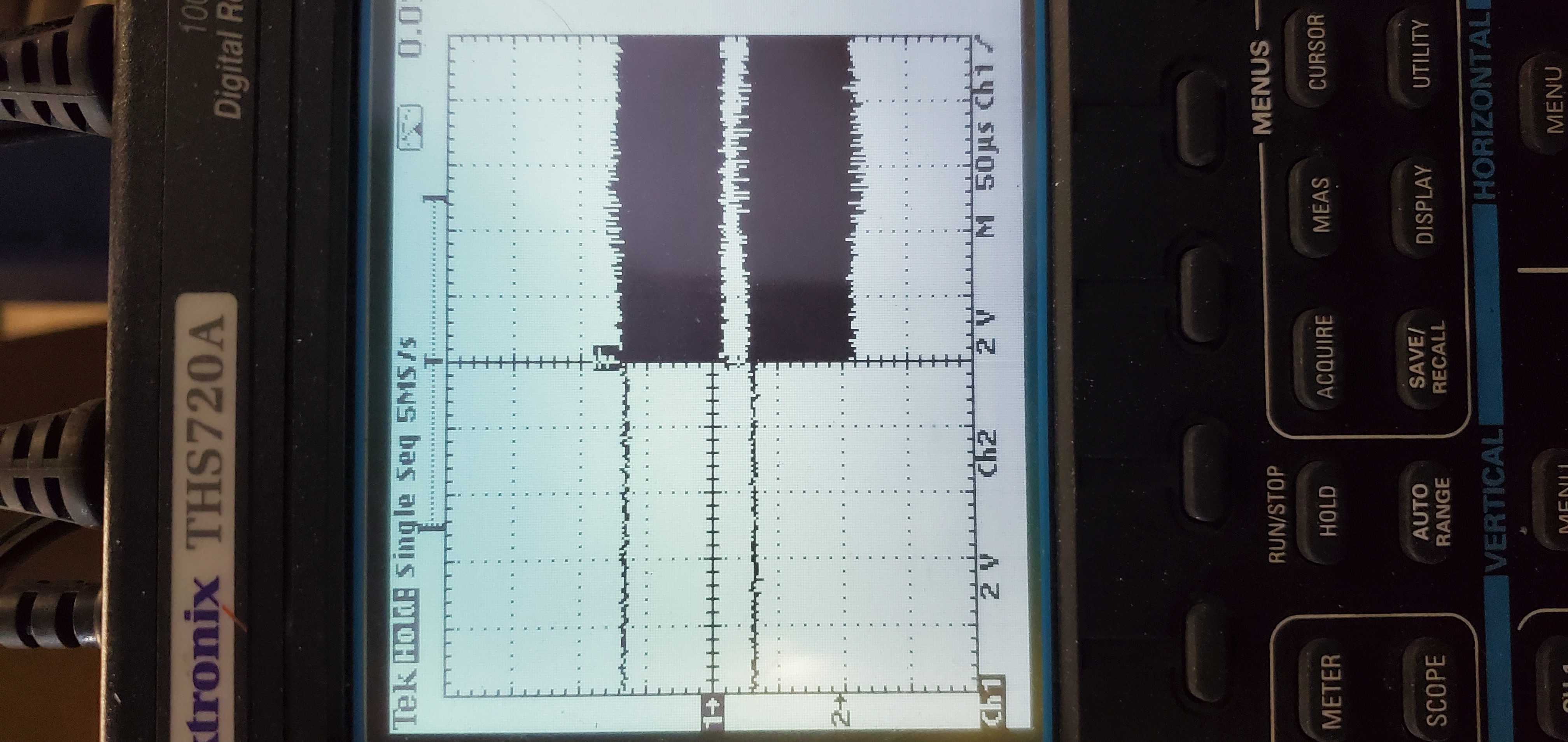

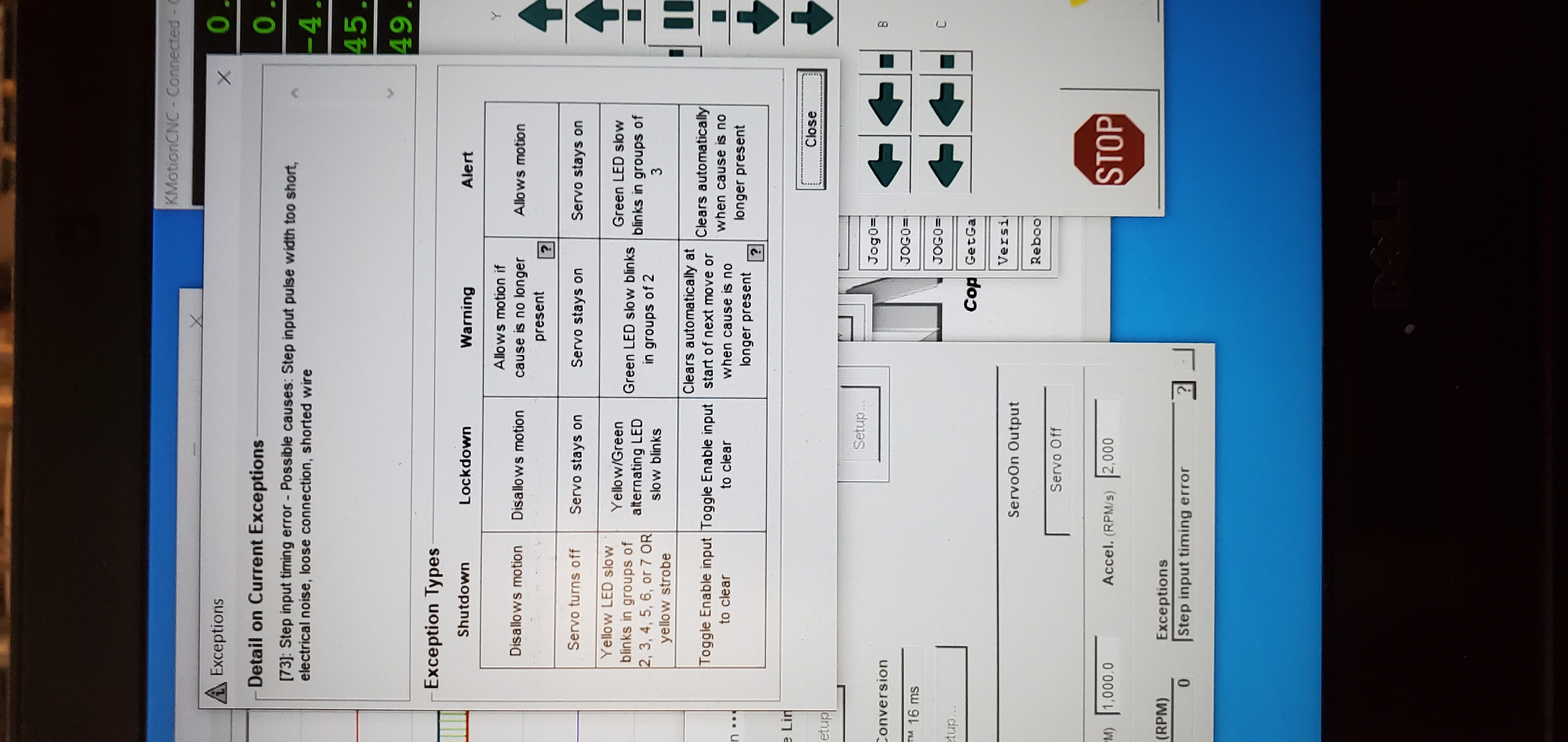

Today I decided to connect my scope to the Kflop output to see if I could catch a bad signal. I connected the Tecknic motor to there software to
monitor the fault. I comes up with a Step input timing error every time when fault accurse. Connected scope to ch0 X1 axis, output 28and 29, JP5 pin 1 and 2 and output pin 36 and 37. This is the 3.3 TTL PNP output. Set scope to capture start of first pulse. Ran RTCP first time and got nice clean Quad
signal. Ran RTCP a couple of more time and finally captured a bad signal and motor faulted as well. Attached picture of scope and Teknic fault.

I can't really follow what you are doing and you aren't answering some of my questions. Please specify step by step what are you doing and what happens. What do the DROs indicate before and after the fault?
The scope seems to show a burst of high frequency pulses. Maybe 1 MHz? KFLOP may do that when the trajectory is discontinuous. Something such as the axis is at say 1 inch and some motion begins starting at 2 inches. This would result in an "infinite" speed jump to 2 inches.

Where was the scope connected when you saw that?

Hi Tom, this signal is at the start of the RTCP motion. I captured the signal coming directly out of the Kflop. Please read my last post again. I am very specific about the scope connection. This is the master signal ch0 which I call X1 which is directly read from the Kflop output (3.3v). X2 is the slave. The DRO's read close to zero for the xyz axis and show the angle of the B and C axis rotation. The DRO XY values do not come back to zero once the program cycle is complete. Yes I am still using the unmodified CKinematics5AxisGimbalCB. I am assuming the values are not coming to zero because I have not set the new CKinematics file. Also I do not have the fault signal output programed yet therfore X Axis stops moving but the rest continue. DRO continues like if nothing happened.

It looks like I found the problem and it seems to be the ch0 output. Here Is a video of the signal coming from the 3.3v output on Kflop at the START of the RTCP program stated above. Soon as I hit the the green cycle start, a bad high frequency signal is triggered from Ch0. This is for a very short time and then the normal Quad signal starts. Once the High Frequency signal is started, the X1 master motor Faults causing X2 to fault right after.
See attached link to Video. Pay attention to to start of the cycle. https://www.youtube.com/shorts/SQy57V_Ydks
So today I reconfigured the Master/Slave to run only off Ch1 with the Quad signals from both motors connected to CH1. Therefore Ch1 is sending
signals to both motors at the same time. Also connected scope to Ch1 directly coming out of Kflop. So far getting no faults and getting perfect
Quad signals every time program starts.

I was able to reproduce that in Version 4.34. I think it has to do with switching RTCP on/off while BC not at Zero resulting in a "quantum leap".
That issue was fixed in Version 4.35e. Please use Version 4.35h
For me the issue (burst of pulses) is perfectly consistent and occurs on both the Master and Slave quadrature Outputs. So I don't understand why changing to drive both Master and Slave from the Slave Outputs should have made any difference.
