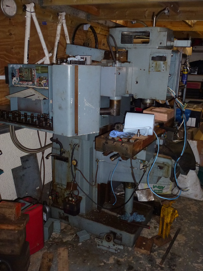

This mill has been sat in my workshop since before I bought the Denford Cyclone lathe, but it kept getting bumped down the roundtuit list, as other machines have taken priority. I think since this machine got rolled into place, a Denford Novamill has been and gone (bought as I needed to make tool holders for the Cyclone, and it happened to turn up at a reasonable price just as I was looking), my little 3040 based digitising machine has been built, and I've bought and retrofitted a Denford Triac mill.
However, as I do various repair work, something capable of handling big lumps of metal is needed, and I've got a plan for a replacement for my Denford Cyclone that will need a big mill to make, so this has finally reached the top of the Roundtuit list.
It's an old Matchmaker CNC conversion that was based on a Shizouka ST-N mill. Think a bit bigger than Bridgeport size, but far sturdier Japanese construction!
It originally left Matchmaker as a stepper driven machine, but at some point in it's history, it got retrofitted with a Heidenhain servo system. The previous owner bought it solely to get the Heidenhain system off it for spares for the Interacts that he ran (or at least that his son ran, as he personally thought they were rubbish!), so I bought the mill as it stands for a bit over scrap value.
Over the years I've had it, I have managed to repair the auto-lube system (needed a new filter, a couple corroded pipes replaced, along with a few blocked metering valves), and get new wiring in for the Summit "one arm bandit" toolchanger pneumatics, and the limit switches. The spindle motor has also been off to free-off the corroded and seized vari-speed system.
So as a few Dynomotion boards turned up yesterday, I thought I'd start a thread about the retrofit.

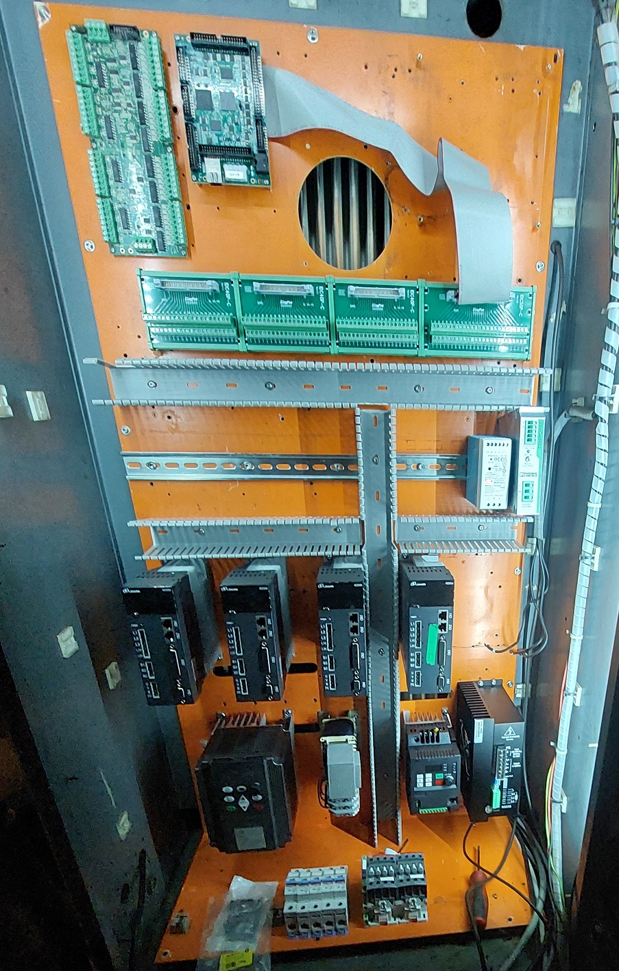

It's now got all main axis servos mounted (required new mounting adapters), and I've spent some spare time over the past week getting all the major bits mounted in the control cabinet -
Starting at the top
Konnect + Kogna (standoffs are also mounted for an adapter plate to mount an Odriod H3+ that I have lying around, which should be ideal for this)
Row of breakout boards. Only a fraction of the terminals will actually be used, as some key connections are on different headers.
DIN rail for various terminals/PSUs
Three 1.2kw Lichuan servo drives for the main axes, and a 0.4kw that will eventually drive the knee (I still need to strip the drive from the knee, and work out how to mount the 0.4KW + reduction gearbox)
5KW 240 -> 380V VFD for the spindle, Sine filter for the spindle motor, 1.5KW 240 -> 380V VFD for the coolant pump (very much overkill, but it's cheaper than a new suds pump!), and a mains power stepper driver for the spindle vari-speed control.
I'm currently sat dithering over whether I need to add another length of DIN rail along the bottom for the 240V terminals/contactors, as I'm not sure the one row of DIN rail will be enough..

Post by BattyZ » Mon Nov 04, 2024 11:04 pm
Looks like the cabinet is off to a clean start!
Not to state the obvious but it's easier to add the din rail now rather than later. Even if you don't end up filling them completely it will still make install and future service easier.

Post by Moray » Mon Nov 04, 2024 11:43 pm
The additional DIN rail has already been added.
I made up a preliminary list of all the 240V DIN rail mounted bits, and everything might have fitted on the other rails, provided I didn't need much room for low voltage bits (most should be wired direct to the breakout boards), but I figured keeping all the high voltage stuff low down would be a better option, rather than having high and low voltage on the same rail.

Post by BattyZ » Sat Nov 09, 2024 9:24 pm
Yeah, one would rather not chance, 'riding the lightning,' just trying to troubleshoot a bit or relay!
