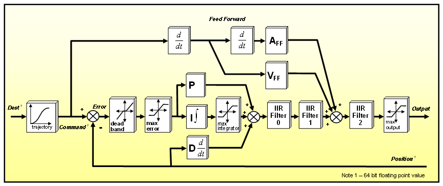

I think what you said is basically correct. But I might quibble with some of your terms. You can't arbitrarily limit the magnitude of the following error. The following error will be whatever it happens to be. Rather the error term into the feedback system can be limited so that the feedback will not "see" such a big error and consequentially not react as violently to the error. Note that the reaction (ramp rate of the output) will be a function of the I Gain x the Error. This flow diagram may help:
