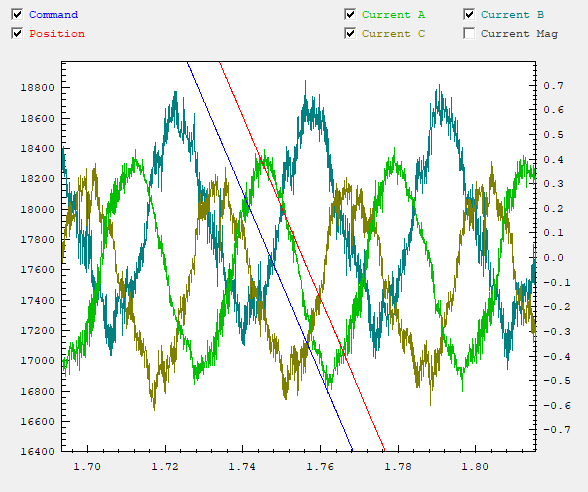

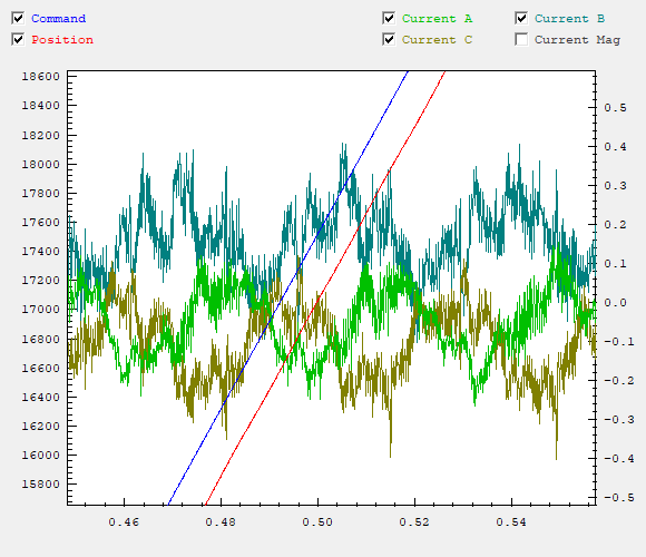

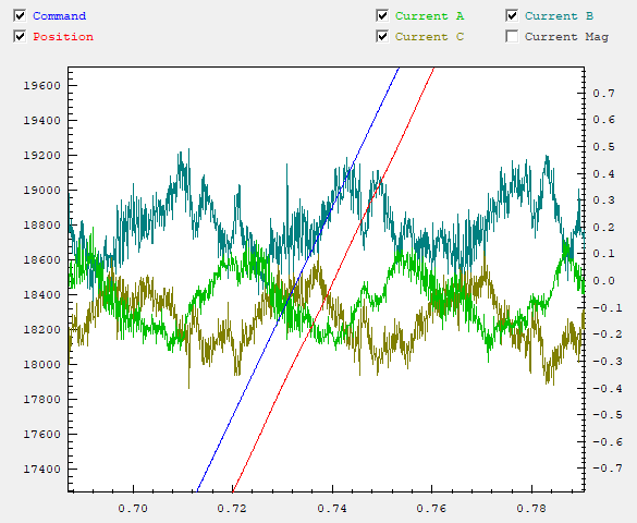

I have two different brand and different spec brushless motors driven by SnapAmps. I found that after setting them up using AutoPhaseFind the current amplitudes were measurably different depending on the direction of motion. I was able to equalize them by adjusting the Commutation Offset value 10 counts at a time initially them 5 counts at a time to optimize the balance CW and CCW. I have a 2048 line encoder on both motors. You can see this difference comparing the current plots for (CGI_2_current_plot) Vs (CGI_2_current_plotA).
I think your adjusted commutation offset is better. But I think the difference might be minor. Note that SnapAmp's current measurement is not extremely accurate. 1% tolerance resistors are involved. SnapAmp has a 70Amp current range so for example 0.1A is 0.14% of the range. SnapAmp only measures the currents in 2 motor leads. The 3rd lead is derived from a+b+c=0 (current in must equal current out).

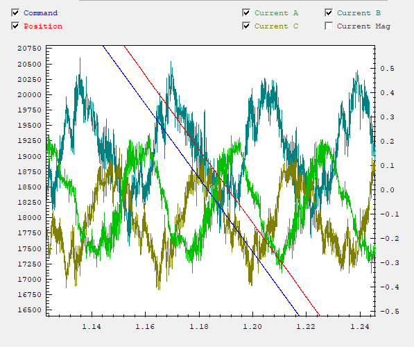

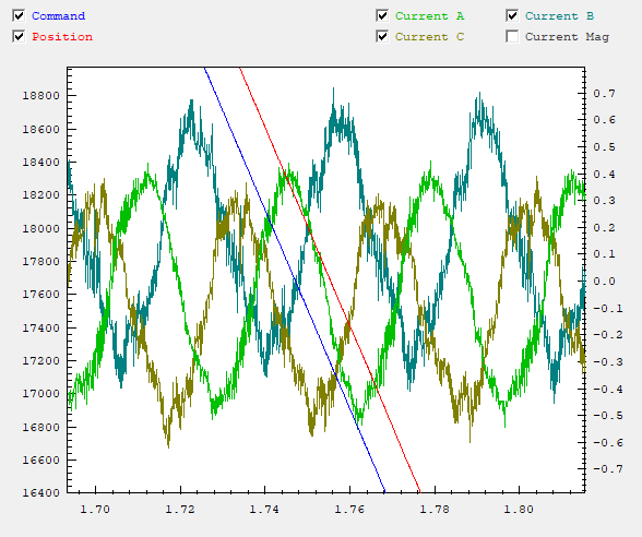

The second thing I saw was that the phase currents were not equal during running at about 80% max velocity.
Attached are the data plots. Use Axis(CGI_0_current plot) for this discussion. The pattern was consistent where running CW phase U was lowest, Then V, Then W. And running CCW the pattern was reversed. I also noticed that the motor was not running smoothly at speed and I attributed that to the variation in currents.
It looks more like a small offset to me:

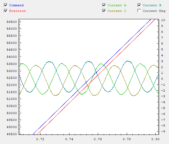

Some additional information:

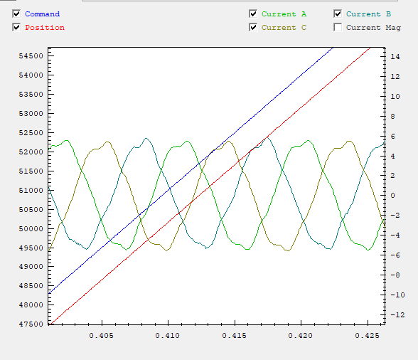

Attached is another current plot with the Axis 0 running at about 90% max speed (300000 with 8192 counts per rev).
The peaks of the sine wave forms all show a Peaky flat where at lower speeds (200000) the wave forms were rounded at the peaks. At this speed (300000) the motor is running with a hum where at 200000 it sounds smooth.
Any idea what this indicates?
I'm not sure. SnapAmp limits the max output voltage to 90% of VBus due to current measurement periods. This is driving the windings at 100Hz so possibly an inductance becomes a limitation. Or it might be a resonance or vibration inducing small currents.
