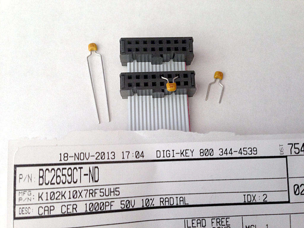

If I install a filter cap on one of the ribbon cable connectors RESET lines, would this same capacitance / filtering be "seen" on all the other reset lines to the other connectors or would I have to install a filter at each connector??
All the resets are connected together but that may not matter for high frequency noise. KFLOP has a 1000pF ceramic capacitor C37 near JP4 placed in a manner that the Resets from JP4, JP5, and JP7 should pass through.

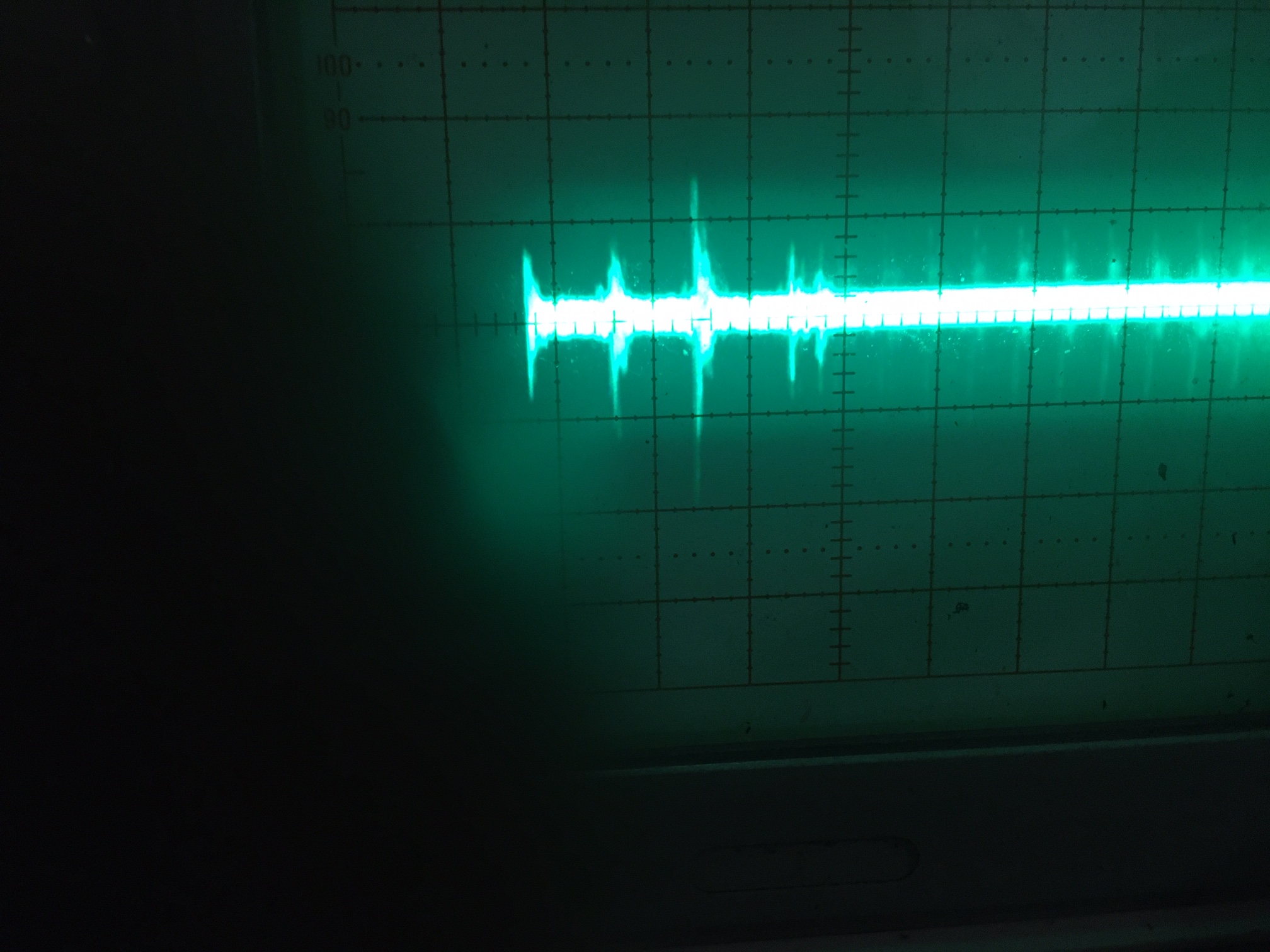

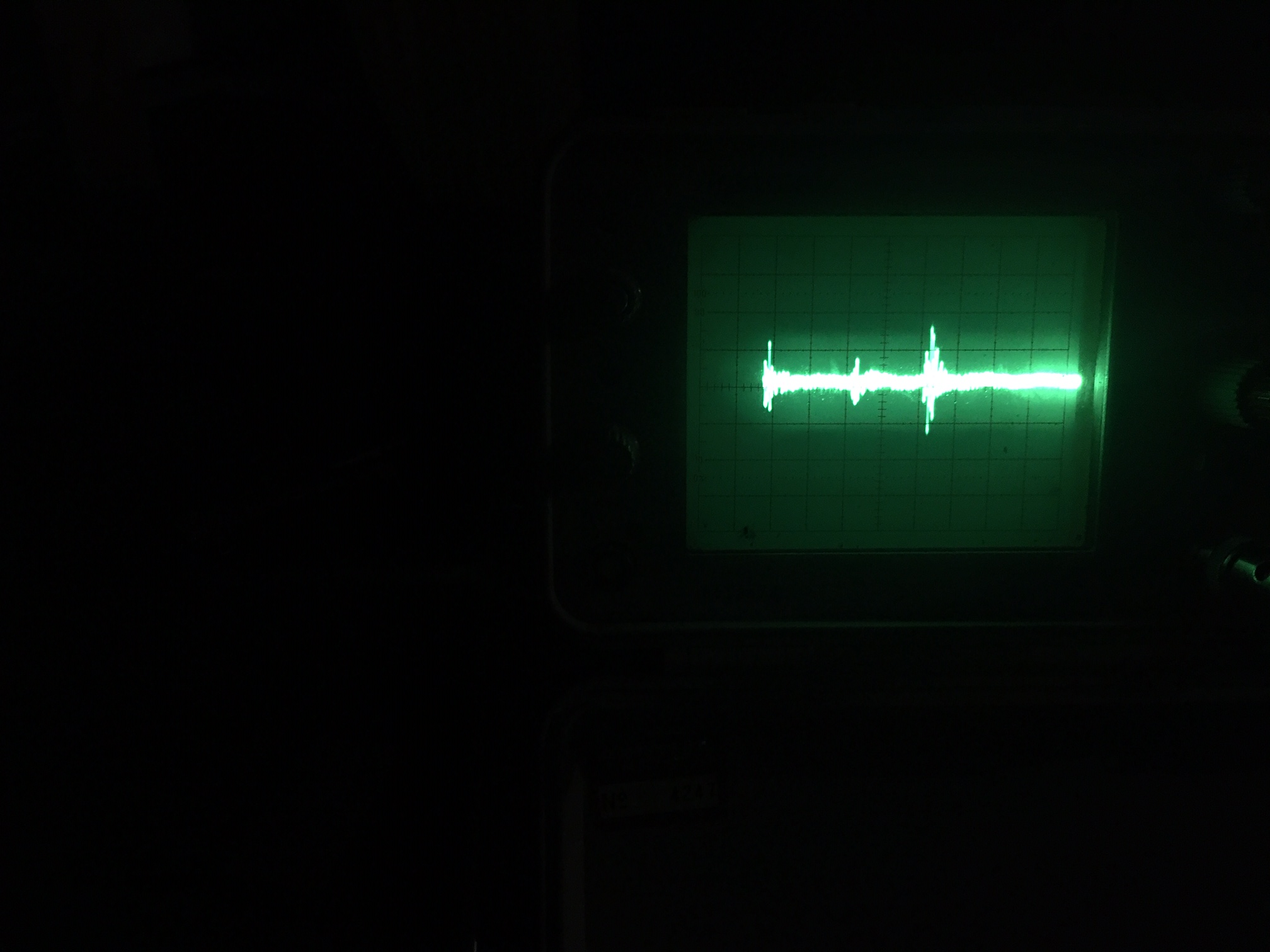

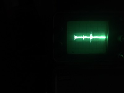

I ran a number of tests and I've attached some oscilloscope photos of what I think may be causing the disconnects.
Each photo shows the 5 v noise measured at the 50 pin connector breakout board with 6 inches of ribbon cable with the ground of the scope at the Kflop ground screw where the two SnapAmp ground wires are connected. The scope is "floating". The amplitude gradient is 0.5 v per gradicle.
I changed the ground wires between the SnapAmp and the K flop to 1/4 in wide flat braid and that reduced the amplitude of the ground wire noise between the K flop and the SnapAmps but the resets continued. Ground wire noise was measured with the scope probe ground at Kflop end of the ground wire and the probe tip at the other end.
Each photo is with only one axis enabled and powered.
When both axes are enabled and powered the two photos are superimposed with the noisiest pulse of the servo phasing back and forth, left and right, and increasing / decreasing amplitude as the motor rotates. The stepper pulses stay where they are but the noisiest one is increasing and decreasing in amplitude as the stepper rotates. The other three stepper pulses don't change in amplitude much. I've swapped the stepper motor wiring to see if the noisiest pulse changes but it stays in the same place in the sequence.
When either the stepper or servo runs by itself the noise pulses are still there but they don't reset the KFlop. When I run them together I can see the servo noisy pulse phasing side to side and overlapping the stepper noisy pulse many times but after about 10 to 15 minutes of running, the Kflop resets.
I have a theory that the noisiest stepper and servo pulses are caused by overlap between the firing of the bridge legs. More specifically, where one bridge leg is fired but the other hasn't stopped conducting yet so a high current pulse, and associated noise, is generated. It seems that way to me because the noisy pulses are always the same ones in the firing sequence. None of the other pulses get anywhere near that amplitude.
Is there a way to increase the dead band "wait time" between firing pulses so we give the current in one leg more time to stop conducting before we fire the other leg? IF for no other reason but to prove/disprove the theory.
Or, on another path, is there a way to further filter the Kflop RESET line?
Is the SnapAmp logic optically isolated from the power section?
AZ
servo noise
stepper noise

OK, I found a problem with one of the servo feedback cables, It has two shields, an internal and an external shield. The internal one is supposed to be connected to 5v common, and the external one is chassis ground earth ground. They were shorted together somewhere within the cable. I removed that motor from the equation, removed all those cable connections etc. Same problem with only one servo and one stepper.
Actually even with all the switching the motor currents should be relatively low and constant. The motors have high inductance so the current changes relatively slowly like on the millisecond time scale. The voltage switches at high frequency. Parasitic capacitance in the wiring/motor might cause high frequency currents (micro/nano seconds).

I can't really think of any. As I stated we have a 1000pF capacitor well placed on the reset line. You might try a larger/smaller. One way to add a capacitor is like this:

I installed a 10000pf cap on the K flop 26 pin on the reset line still running open loop on both motors. Same result
