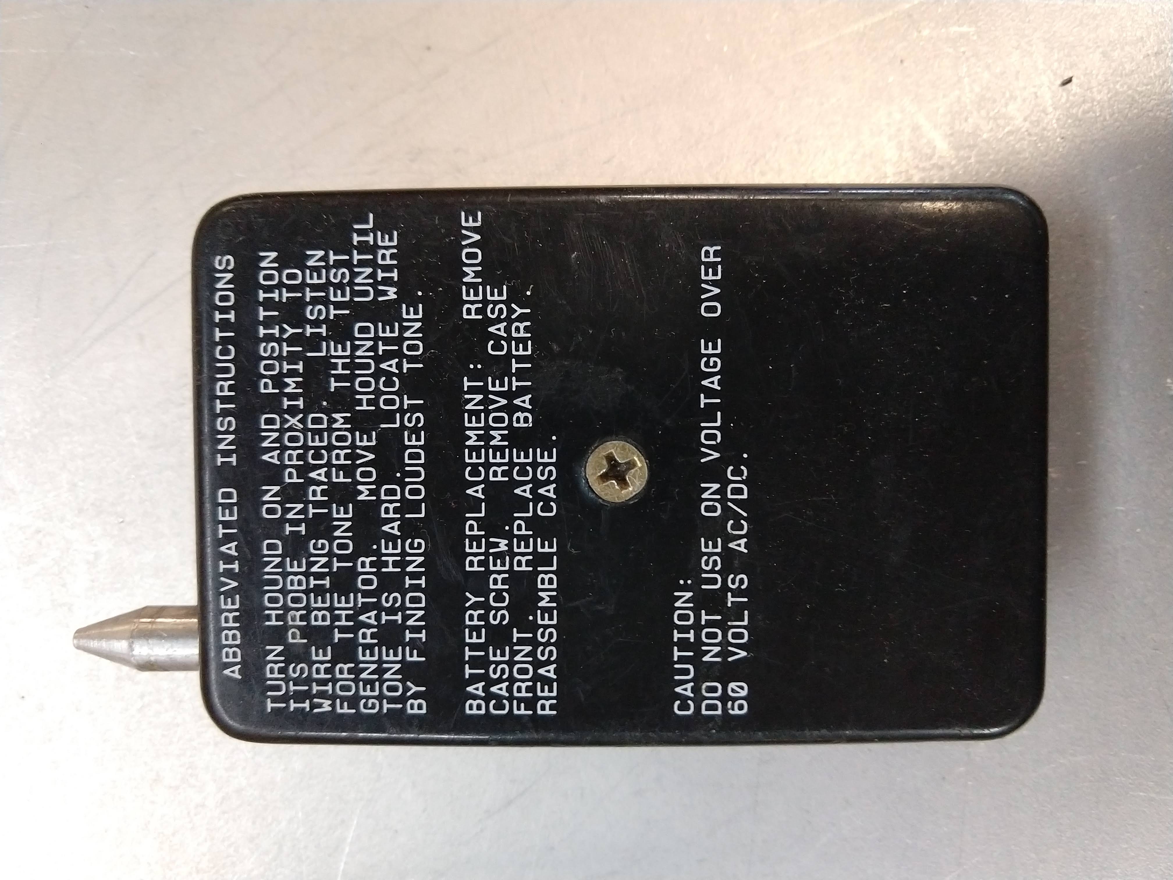

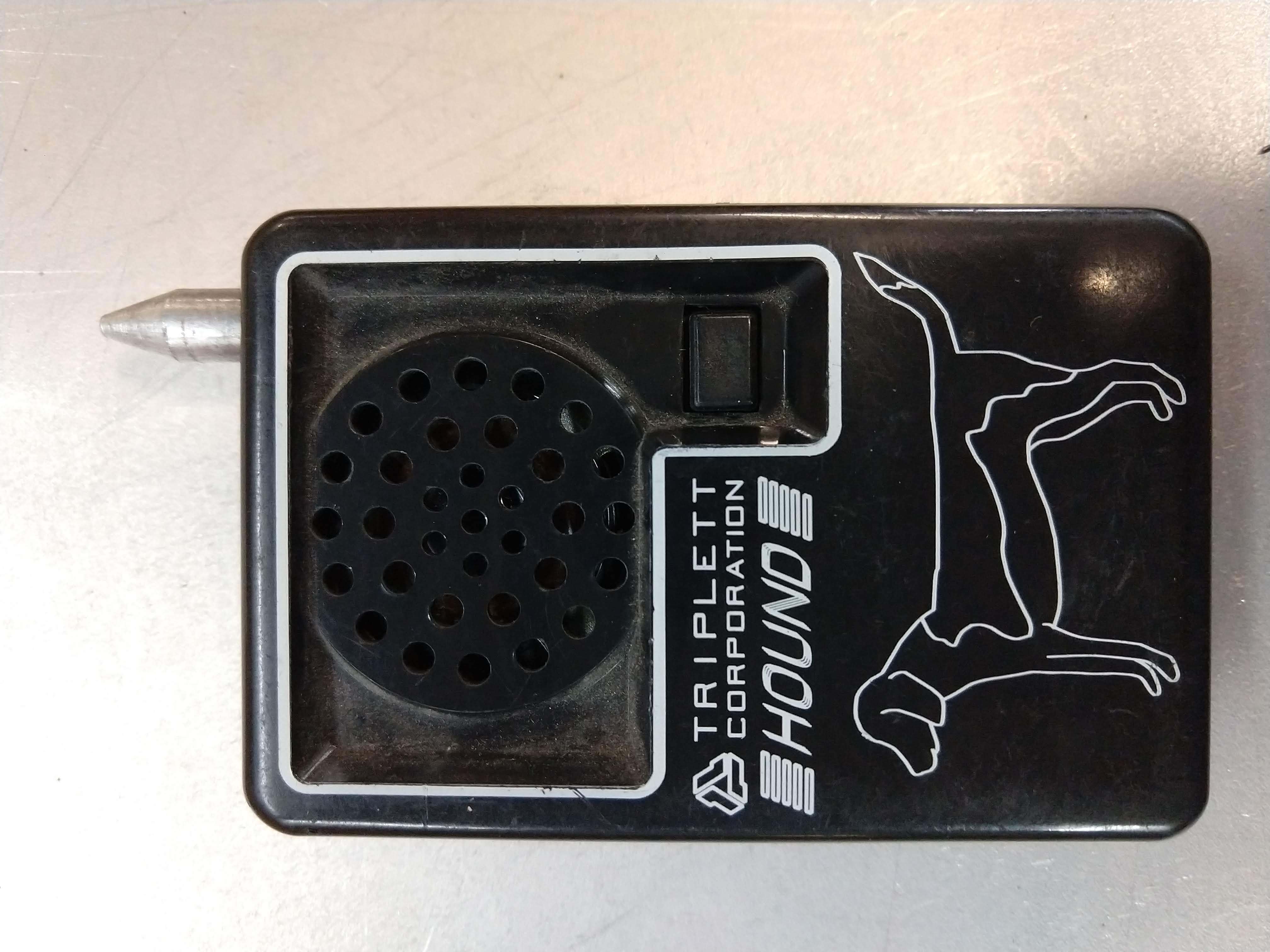

I tried using my tone/wire tracer to detect noise. It works pretty good as a rough indicator. It is part of an old "fox and hound" set by Triplett.
They still make a newer version. I did not use the tone generator "fox", only the "hound" receiver as shown, since the tone is the noise in then lines. It does give me some answers and some items to further test with my scope. Lots of ringing through my encoder lines when the brushed servos are enabled. I think some more refined tools may be some "sniffer" near field probes for oscilloscope or spectrum analyzer. I do not have an analyzer. I need to look further to see which probes are best suited and if I can make use of them with my sampling type Rigol DS1054Z scope.
