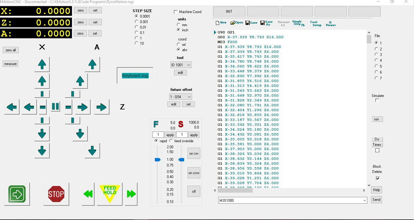

so after playing with this for some hours i got something close to complete
i soon realized this editor is like putting together a puzzle from a box, with only a given amount of pieces that can not be removed, and you build it with a Nintendo controller. not very high tech/high speed :lol: but it works.....
my requirements
1 full screen 1360 x 768 resolution of my monitors
2 X, Z and A axis control and read out
now in my final leg of this journey i think the only trouble is that my A axis controls the X axis on the machine
X axis on the control does nothing....
TTurboLathe.scr
(61.44 KiB) Downloaded 1408 times

I assume you are referring to the Jog buttons?
There is a Lathe option in Tool Setup that basically swaps XZ to ZX
from
Right/Left and +/-Z Buttons controlling normal X Z
to
Right/Left and +/-Z Buttons controlling Z X respectively.
Is that enabled?
If so,
for your X buttons you should use the Zplus/minus buttons (You are using Up/Down which maps to Y which is why you get nothing)
for your Z buttons you should use the Right/Left buttons (Looks like you are)
for your A buttons you should use the Aplus/minus buttons (You are using Z for some reason)

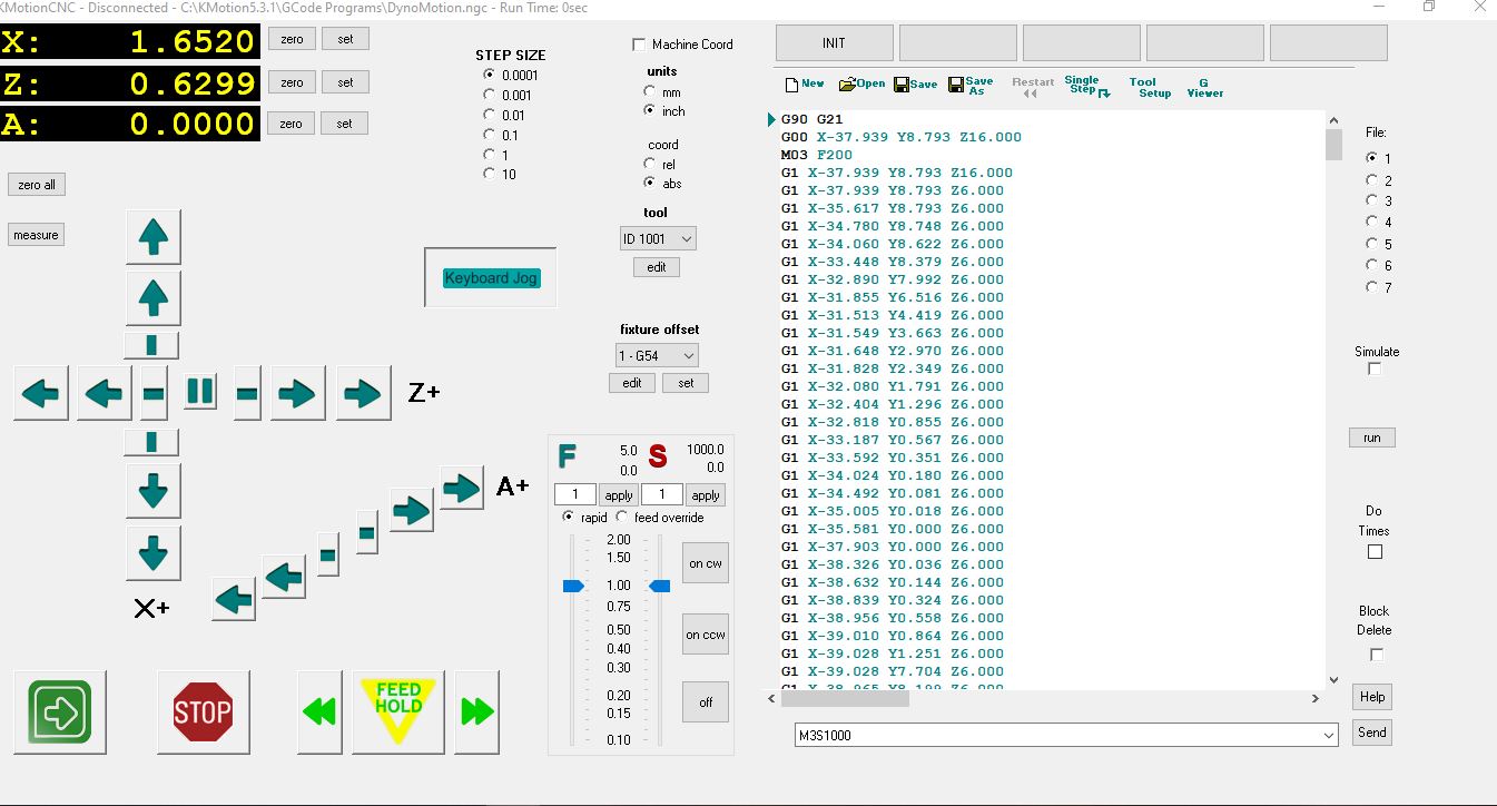

ok, 8 hours into this and it is pretty much ready to get dangerous and try some cuts
i cant thank you for your help and patience with this stuff!

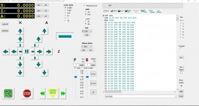

Post by turbothis » Fri Mar 15, 2024 10:15 pm
dang, got everything looking good and now cant get any G viewer toolpath
I'm even using the basic 2 axis lathe one
